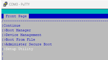

Hi everyone,
I have a problem after rebooting a PA440. The device simply puts a message on the console that no bootable media has been found and then shows a BIOS-like menu with several entries (boot manager, system setup etc.). However, if I select one of these entries, it asks me for a password - neither the serial number, MA1NT, admin nor the password I set seem to work...can anyone help?
Thanks!
sounds like your disk may be broken, it's best to open a support case and get an RMA in this case

I had the exact same issue with PA 440
paragkarki143_0-1673569201390.pngparagkarki143_1-1673569226420.pngparagkarki143_2-1673569242415.png
This meant the DISK is not working and we proceeded with an RMA
I hope this will help people facing the same issue.
