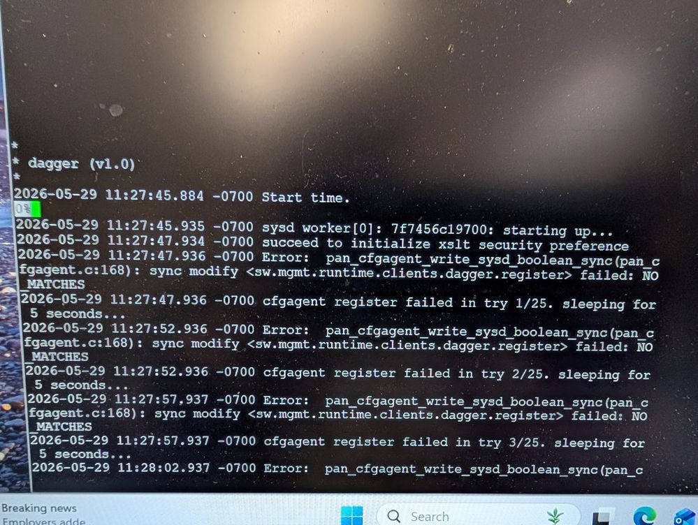

Your line 1 of code was correct, it did bring up the dagger log. Here is what its currently showing. Dagger log.jpg
Hi @mike.tinklepaugh ,
Your logs are not showing a hardware failure (like a dead drive or bad RAM). Instead, it's a software/configuration sync error where a background management agent is failing to register properly during bootup.
PAN-OS uses a configuration agent (cfgagent) to talk to system daemons (sysd). The boot process is trying to set a runtime flag to say "dagger" (a cloud-management/telemetry component) is registered.
The FAILED: NO MATCHES string means the system configuration schema doesn't recognize that exact setting path. It’s a software mismatch or a corrupted runtime state database, not a broken piece of metal.
It says cfgagent register failed in try 1/25... 2/25... 3/25. The system will loop 25 times over several minutes hoping the dependent services finish starting up in the background.
If this screen just popped up, let it complete the 25 attempts. Sometimes the master daemon is just slow to initialize, and attempt 5 or 10 will suddenly succeed.
If it completes 25/25 and drops to a maintenance prompt or hangs, power-cycle the device completely to clear out the corrupted sysd runtime state.
If it loops continuously on every reboot, the software image or runtime configuration database has become corrupted (likely after an interrupted upgrade or power loss).
  • Intercept the boot sequence via the console cable to enter Maintenance Mode.
  • Run a Factory Reset or select a previous PAN-OS version to restore clean software functionality.
If a factory reset or a sysroot switch fails to resolve the loop, then open a TAC case for an RMA, but tech support will almost certainly ask you to try a factory data reset or a clean software reinstall via maintenance mode first!
