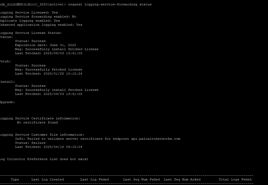

1.) 3rd Gen firewalls (PA-800s, PA-3200s, PA-5200s) did NOT come with the Device Certificate. You have to fetch it using the OTP method (from Device Certificate in Support Portal). "request certificate fetch otp ##############################"
2.) Run the "request logging-service-forwarding status" If you are missing the Logging Service Certificate (see screenshot), then run "request logging-service-forwarding customerinfo fetch"
3.) Port TCP/444 has to be open for the firewall to fetch server certificate when doing the "request logging-service-forwarding customerinfo fetch" command (see screenshot)
I found this helpful trying to get IoT Security working on a PA-3220. We were not seeing any devices make it to the IoT dashboard until the Device Certificate and the Logging Server Certificate was fetched successfully.

@apiche1 wrote:
Bump for an old thread, however I found more relevant information.
