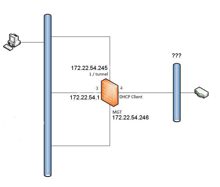

hello,
i have a setup like the image below.
my goal is to allow internet throught interfaces 3 and 4 (i have a virtual router with these 2 interfaces, vr_l3) : this is working
i have an IPSEC tunnel on interface 1 (with another virtual router, vr1) to route 172.22.0.0/20 : this is working
i have a dhcp server on interface 3
if i put a route directly on the workstation, this is working (route add 172.22.0.0 mask 255.255.240.0 172.22.54.245)
next i would like to have the firewall doing this
1/ first i tried to make a static route in vr_l3 to 172.22.54.245
strangely, i have ping which is working but web-browsing is not
2/ secondly, i tried to route to the next vr, vr1
but i have nothing working
3/ third, i try to put a static route in dhcp server
option 249, 14AC16AC1636F5
but this is working on a PA220 and not on a PA200 7.0.19 : i can't obtain an ip address when option 249 is set
i don't think it's a policy problem because i currently have a any-any rule to allow traffic
yes, this command :
set deviceconfig setting tcp asymmetric-path bypass
did the trick
but what will be the aftermath ?
If ping is working, but everything else doesn't, then it's very likely that you have asynchronous routing. Ping request is sent via the firewall, but the reply is taking a different path (bypassing the firewall).
