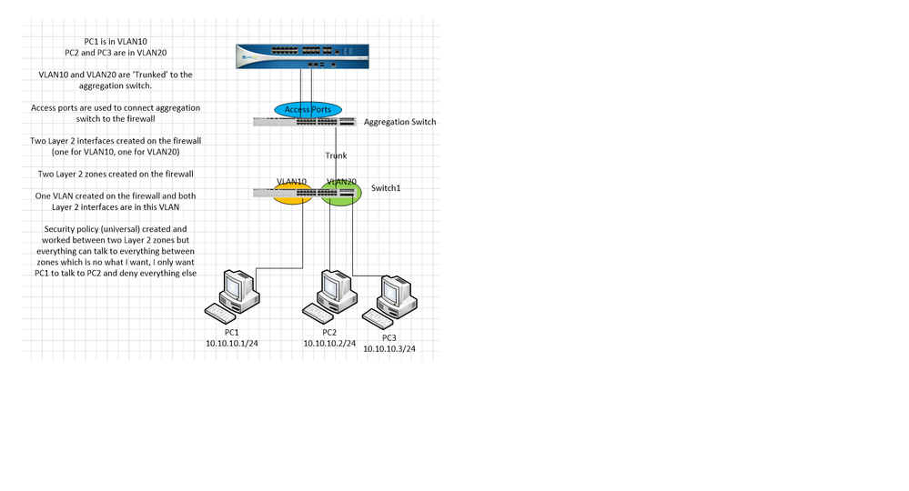

Hi Steve, thanks for you reply, we cant change the IP addresses of the devices hence we have to use layer2 ...
There are two Cisco switches:
Switch 1, where all PCs are connected to, two VLANs created on this switch: -
PC1 is in VLAN10
PC2 and PC3 are in VLAN20
Aggregation Switch
VLAN10 and VLAN20 are ‘Trunked’ to the aggregation switch.
Access ports are used to connect aggregation switch to the firewall
Two Layer 2 interfaces created on the firewall (one for VLAN10, one for VLAN20)
Two Layer 2 zones created on the firewall
One VLAN created on the firewall and both Layer 2 interfaces are in this VLAN
Security policy (universal) created and worked between two Layer 2 zones but everything can talk to everything between zones which is no what I want, I only want PC1 to talk to PC2 and deny everything else
Please find attach image for reference.
Hello
Your issue is that you created a single vlan on the FW, and associated both interfaces to that vlan.
The put the zones into the same vlan.
You should create 2 vlans on the FW and put vlan10 in PC1 zone, and vlan20 onto PC2
