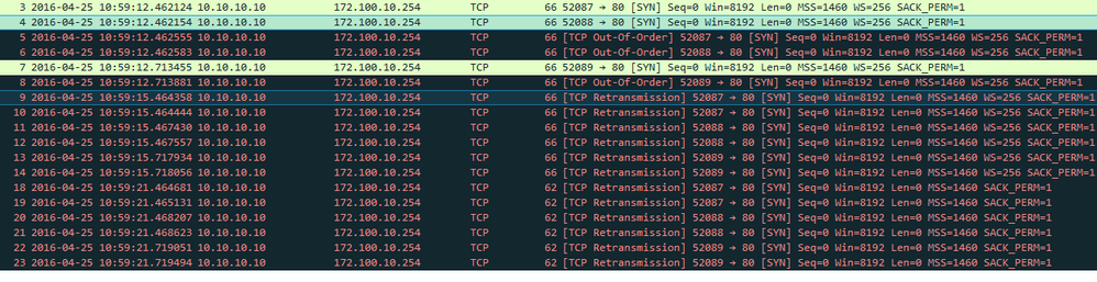

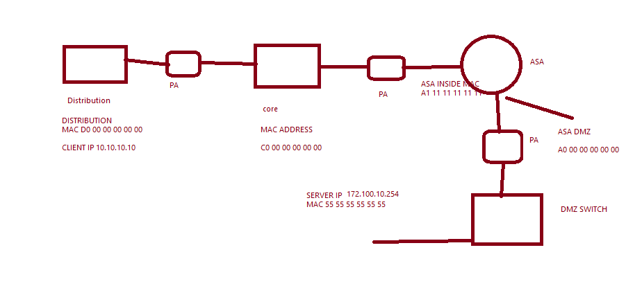

I have attached the rx  capture file  , and   topology
filter  : source  10.10.10.10  destination 172.100.10 .254
Please help to understand

so the pcap doesn't look good, there's only outgoing SYN packets and no reply
you indicate there are 3 PA firewalls ? i'd start by setting up pcaps on all 3 with these filters:
1 10.10.10.10  - 172.100.10.254 d-port 80
2 172.100.10.254 - 10.10.10.10 s-port 80
(unless there is NAT, then you'd need to adjust the IP's)
and if possible, also on the ASA
that will allow you to track the whole path the packets need to traverse so you can pinpoint where the link
-if you see the syn packet on all firewalls, you know it was delivered to the DMZ switch and something went wrong there
-if you see it on the first 2 PA's but not on the 3rd PA, you'll know it's on the ASA
-if you don't see it on the second PA you'll know it's going wrong on the core
since you're only seeing SYN packets, i'd also focus on the TX pcaps first, to make sure they're leaving the firewall
Actually  there is only one physical firewall ,those three are in differnet zone
ok, that makes things a little more tricky 😉
did you make sure every single interface has a unique zone (the single session should go through 6 different zones)

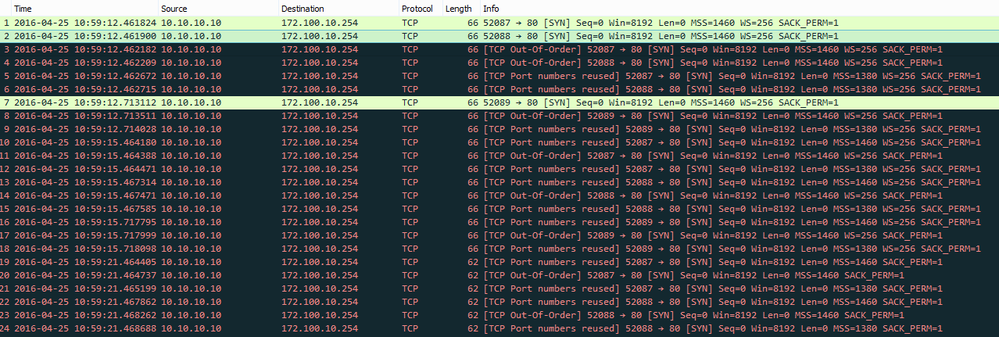

Here is the tx , it seems  packets are leaving firewall ?

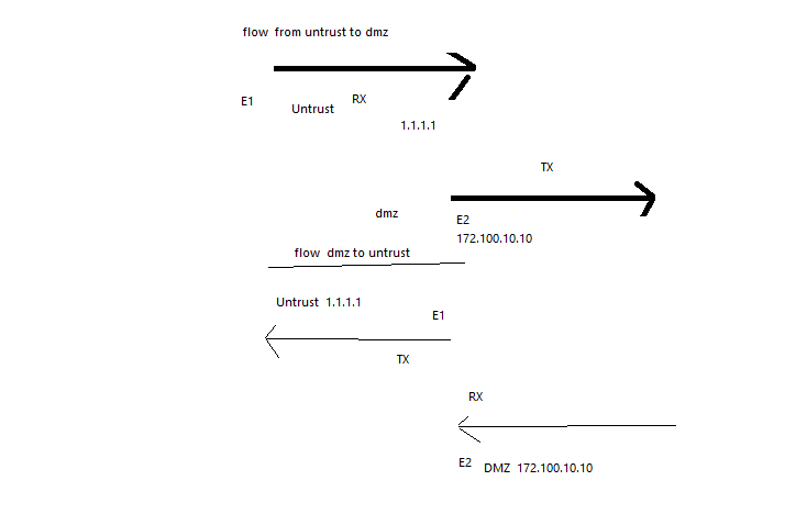

As per the  below diagram  rx of both interface will be  recordeed in rx stage  and tx in the tx stage,
At firewall stage what all will be recorded

if you see packets in the transmit stage, that means they are leaving the firewall on the egress interface
the tricky part in your case is that the packets go in and out of the firewall 3 times, but i only see 2 transmits (look for source port 52087) and then a retransmit, so according to your initial diagram, that would mean the ASA  could be blocking your connection
the first transmit is from distri to core, the second entry is from core to asa, the third one should be asa to dmz
if you now compare the transmit to the receive, you can see if the receive also only has 2 entries, which means the packet from asa was not received, or if it has 3 entries, which means the 3rd leg of the PA firewall received and dropped the packet
