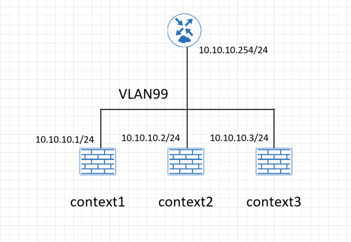

In my case it is just a simple migration of 3 Cisco ASA virtual contexts to Palo Alto in 1:1 fashion. Since Cisco ASA has no problem with having subinterfaces with same dot1q tag on different contexts it was supposed we proceed with a migration in similar fashion to Palo Alto vSys. Right now it looks like it has such kind of limitation though, which is not a problem on Cisco.
Please see attached picture of our current design. We want to have only single port-channel between PA box and switches. All logical subinterfaces should be hanging off of it.
So the question is - how can we work around this problem and if adding another physical interface for each context is the only solution?
So, let me see if I understand this, you have the three contexts at the bottom of the diagram and you are wanting to share the gateway that is on vlan 99 across the three VSYS ?
If this is the case then I would look at the shared gateway implementation as this would fit your use case perfectly

We need to have L3 interface on each of 3 new vSYS on PA box, which is sharing same IP subnet and (ideally) VLAN ID. This is required as we have multiple networks routed through each firewall context and those L3 interfaces are acting like next-hop-address.
So in my picture above 10.10.10.254 is the common gateway for all 3 contexts, but it is not located on FW, it is just a router which has interface within same VLAN/Subnet.
I see, I would like to go away and Lab this up, I am sure there will be a way to make this an easy migration, just for confirmation sake the Vlan that needs to shared across the VSYS in this example is 99 yes ? and then the three contexts are the nexthop gateway for your subnets ?
Check out my YouTube channel - https://www.youtube.com/@mode4480
That's exactly correct. So in our design simplified from a router point of view on top of the pic we have for example:
1. Network A, next-hop is 10.10.10.1/24;
2. Network B, next-hop is 10.10.10.2/24;
3. Network C, next-hop is 10.10.10.3/24
So in fact 10.10.10.0/24 is a transit network between router and firewall contexts.
