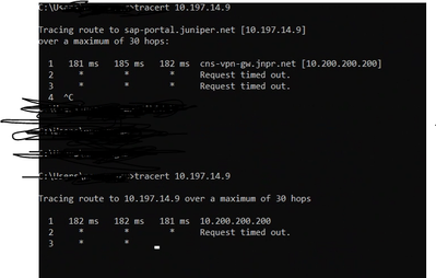

Hi I did a ping test, and it shows that it enters the lan and exit the same lan interface and its aging meaning its not complete.
I did a nslookup both any connect and GP
above is connected to any connect while below is on GP

Did you add only the IP 10.197.14.9/32 to the GP SPLIT ? ... Do it.
Ok, so if the ping does not complete then we may have a problem. If you have no response to ping then either the server/app has Ping disabled. As I mentioned before, do you have another device/server/printer, endpoint, that does respond to ping from GP on the same network segment as 10.197.14.9/sap-portal.juniper.net e.g. 10.197.14.5 ? 10.197.14.8 ? 10.197.14.3 ? or other to validate if something on that exact network segment responds to ping and responds correctly ? (Make sure you have the Palo Alto FWs security policies allowing this ping traffic).
Did you check if the L3/routers or intermediary devices have the return path to the GP network, i.e. the Network or subnet range that you indicated in the FW in the Global Protect config to assign to the endpoints with GP client.
In the Log Monitor traffic log, when you track the ping and telnet connection ( you did telnet 10.197.14.9/sap-portal.juniper.net port 443 , i.e. telnet command 10.197.14.9 443 ) you have only sent and not received bits ?
Now from a computer stopped on 10.197.14.X ( for example from the server or other device ) if you try to ping or trace to the FWs for example to a GP IP endpoint ( you must allow with security policy the traffic from trust to GP zone ) the trace at least reaches the GW of the FWs PAN ?
