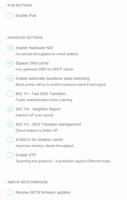

At the time of installing Global Protect and using it without any issues my PC was using an external USB WiFi adapter to connect wirelessly to my home Amplifi HD mesh router.
I have now added an Ethernet cable from the same Amplifi HD mesh router to my PC and was expecting to be able to use this connection of all activities on my PC.
With the external USB WiFi adapter disabled in Windows and the Ethernet cable connection enabled in Windows I'm am to connect to the internet as I did before but have much faster speeds.
Unfortunately in this configuration the Global Protect doesn't work.  If I use the Ethernet cable connection Global Protect will connect for say 30 seconds and then disconnects and this keeps repeating until I click the "Disconnect" button on Global Protect.
Whilst Global Protect is connected I lose ALL internet access on my PC.
The only way I can get internet access back on my PC is to disable the Ethernet cable connection in Windows and then re-enable the external USB WiFi adapter in Windows.
I can't see any difference between the two network connections on my PC and have tried disabling my Firewall but that has no effect.
Does anyone know what else I could try?

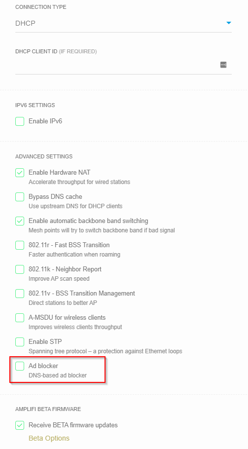

@adrian109 - I am experiencing the exact same issue, and I also have the Amplifi HD mesh router. Seems like more than a coincidence...
@adrian109 - Did you happen to configure any Amplifi options via the web interface (as opposed to the mobile app)? I enabled the DNS Ad Blocker from there a while ago but didn't think to look there since Wi-Fi worked just fine (so long as I disabled the Ethernet interface).
So... I just now unchecked the DNS Ad Blocker setting and retried everything, and it looks like my Ethernet works again!
Doesn't look like I have the DNS Ad Blocker enabled unfortunately.

I guess I spoke to soon... after about 30-45 mins, I was disconnected and could not reconnect via Ethernet. Before I changed the Ad Blocker setting, GP would actually say I was connected yet I couldn't access ANY sites at all, similar to you - and I would have to literally disable the Ethernet adapter for GP to work via Wi-Fi... This last time (after disabling the ad blocker), I didn't need to disable the Ethernet adapter - just connected to Wi-Fi and refreshed my GP connection.
I am on 3.4.3 as well - but not beta... I tried the DNS cache bypass too, and it didn't fix it either. I may try the NAT setting next.

It does appear to be an issue with the Amplifi HD because I have just done a test with it totally removed from my network as I plugged my PC directly into my Virgin modem, in this configuration the VPN stays connected and I retain internet access on my local PC.
I have sent my support logs to Amplifi to see if that can help them diagnose the issue.
Amplifi support have been in contact with me since I sent them the logs from my Amplifi HD.
They have asked me to disabled the Hardware NAT setting and to test again to see if that has any difference.
I can confirm that with the Hardware NAT option disabled I can now connect to my work VPN using GlobalProtect and the connection still allows me to use my internet connection on my local PC.
It seems to be the Hardware NAT setting that is causing the issue when using a wired connection.  I noticed next to the Hardware NAT setting on the UI screen that the description says "Accelerate throughput for wired stations".
I guess that explains why it worked when connecting to the Amplifi HD using wireless as that setting doesn't apply to wireless clients.
I'm glad that we have managed to pinpoint the setting causing the problem, but I'm now concerned with this setting now disabled I won't be getting maximum throughput on my wired clients.
I can remember and have seen a lot of posts / articles that recommend having this setting enabled.
I am not sure if disabling this setting will have any negative effect or if its an issue with the Hardware NAT that needs to be fixed so that people like myself that had that setting enabled can use their VPNs?
@adrian109 Thanks for the update. I have disabled my HW NAT now as well, and will see how that goes. I have another computer using Ethernet that has been fine for years - or however long it's been since HW NAT was introduced - so still not sure why it would have a problem with GP client and no other software that I use (including other 3rd party VPN clients )... Keep me posted!
