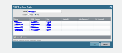

We had configured SNMP V3 to forward all the logs to SNMP V3.
Is username/Engine ID/Auth and Private Password need to be configured for SNMP v3 to work properly

For SNMPv3 Trap, the: EngineID is optional. If you do not set it up, the Firewall Serial Number will be used as an EngineID, however Auth Password and Priv Password are mandatory. The Auth Password is used to authenticate to SNMP manager and Priv Password to encrypt Traps.
Could you set these options and try it again?
