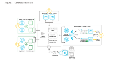

I am looking for some clarity on the Overlay routing feature on VM Series FW.
I am using the Combined (Centralized Egress + Distributed Ingress) deployment model described in this Securing Application in AWS - Centralized Model Deployment Guide

In this pattern, overlay routing is enabled so that the FW can handle both inspection and NAT for outbound traffic flows. It allows packets to leave the VM-Series firewall through a different interface than that which they entered through.
I have built this out in my lab and it works well but I want to understand why it does.
Egress Traffic
I understand for outbound flow (Traffic initiated from the VPC to the internet) - The traffic from the EC2 instance leaves the VPC via the TGW and lands on the TGW attachment in the Security VPC, which then sends it to the GWLB endpoint for inspection on the FW. With Overlay routing, the FW is able to check the destination address (internet bound) and directly route it out its public interface.
EC2 --> TGW (App VPC) --> TGW (Security VPC) --> GWLBe --> (inside)VM Series FW(outside)---> IGW
Ingress Traffic
Here is where it gets confusing. For inbound traffic (Traffic initiated from internet to VPC)
Inbound flow
The traffic first hits the GWLB endpoint in the app VPC and gets send to the Inspection VPC for inspection, FW inspects (destination is app VPC) and sends the traffic back out the inside interface. Traffic gets send back through the GWLB endpoint and on to the ALB and to the EC2 instance
Client --> IGW --> GWLBe(App VPC) --> GWLB (Inspection VPC) ---> (inside)VM Series FW (inside) --> GWLB (Inspection) ---> GWLBe (App VPC) ---> ALB (SNAT) ---> EC2
Return flow
Here the EC2 responds directly to the ALB private IP, ALB forwards to the internet via the GWLB endpoint, which then gets sent to the Inspection VPC for inspection, FW inspects and sends the traffic back out the inside interface to the GWLB and it makes it way back to GWLB endpoint in the App VOC and to the client on the internet.
EC2 --> ALB (APP VPC) ---> GWLBe --> GWLB --> (Inside) VM series FW (inside) --> GWLB/GWLBe --> IGW ----> Client
With overlay routing, I expected the FW to see that the destination address on the return flow is internet bound and should have sent it out its outside/public interface (like it did on the outbound flow) - which would of course break the flow and cause asymmetric routing.
How does the FW know to send the return flow back out its inside interface?
I did not have to configure any PBRs to influence the routing.
