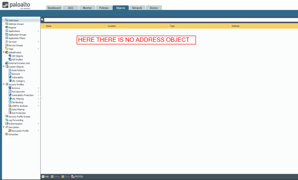

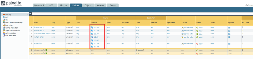

Do i have to create address objects before i add security rule ?.
Or if i add a security rule via ansible, shouldn't be objects created automatically in the firewall ?
In my case i see the security rule is created and in the rule row i can see the source ip but in the objects tab i cannot see the object i have used in the rule.

Thank You for your detailed reply @gfreeman I have used the sample you have sent and see the added address object in the firewall.
