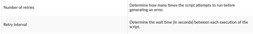

Hi @Antanas, you can use the retry option for a specific playbook task. Refer - https://docs-cortex.paloaltonetworks.com/r/Cortex-XSIAM/Cortex-XSIAM-Administrator-Guide/Playbook-Ta...
Hi @jfernandes1 ,
Definetely, I'm using this option to overcome temp API issues which happen on short time period, like repeat the task 3 times every 60 sec. But in order to address the longer lasting issues, i need either additional repeat X times every e.g. hour, or manually rerun each task.
