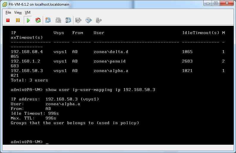

have you validated that the firewall has a mapping of the IP to User?
Do you see a deny log showing the ICMP request with the source user the traffic is being generated from?
Yes it connects to the AD brings back the userid mappings, and yes it is dropping the ICMP ping, but as I mentioned if I delete the user the ping works.

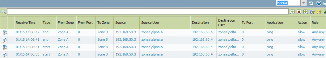

When you are lookigng at the logs, Click the maginifying glass on the far left and see if its picking up the username.
When you say "it brings back the user id mappings."  Does it actually provide the IP to User ID mapping for the source user in question?
In the deny log, does the denied ICMP request show the source user ID that you're expecting?

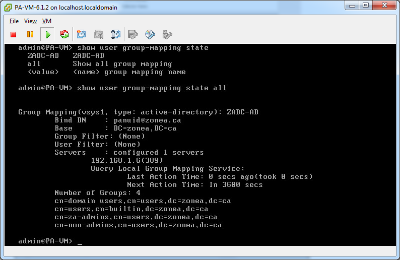

Also if you're using a "group" in the rule do you have that group in the "Group Mapping?" In the user identifcation in the "Group Include List?"
Yes, I've even removed the User Identification setting commited and configured it again and still the same issue

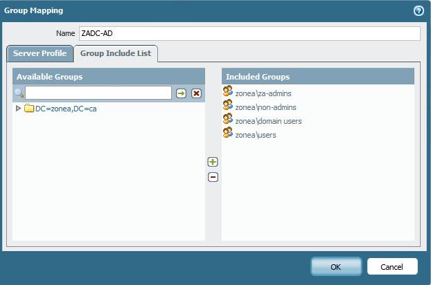

Groups

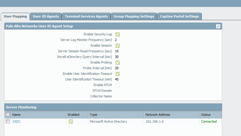

User Mappings
User
All the groups
Group Domain Users

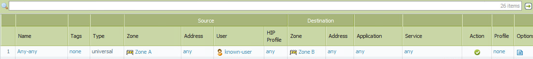

Rule that works

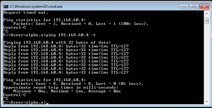

Ping Allowed

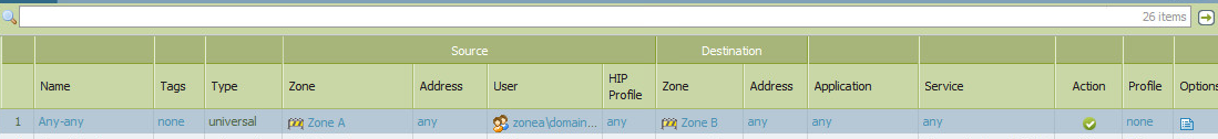

Rule that doesn't work

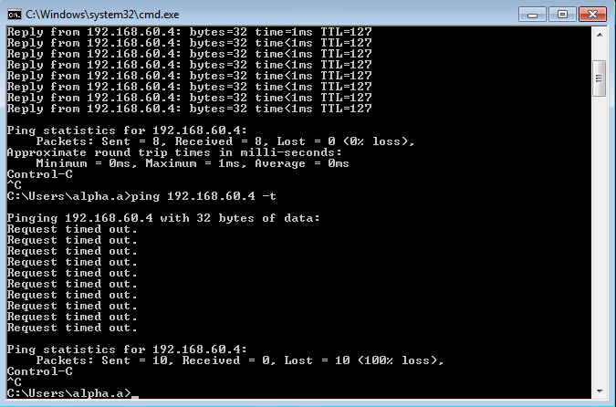

Ping dropped

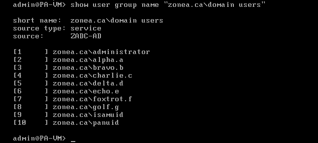

Hi
In your group mapping, the users are mapped as 'zonea.ca\user' while in the user mapping, the user is 'zonea\user'
This means the mapping information from the group is set to the FQDN while the uidagent collects the netbios domain
this causes a mismatch when your security policy is set to a group

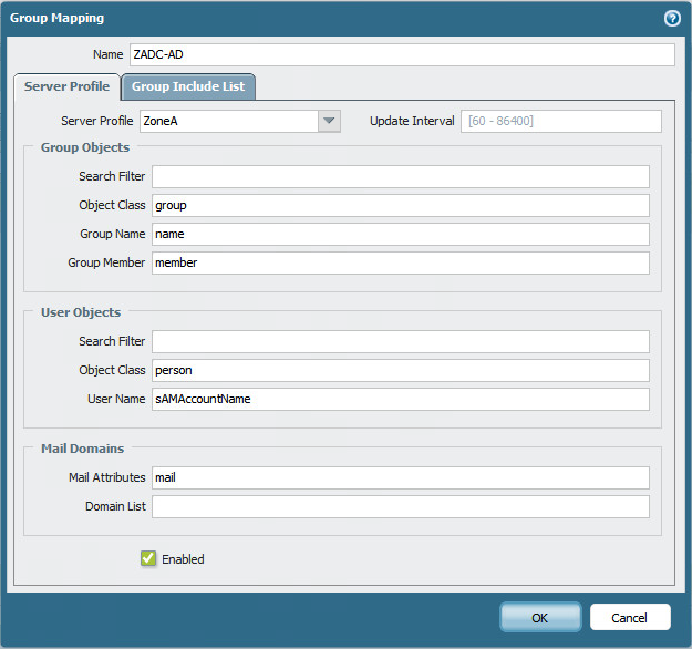

you can resolve this issue by setting the group mapping user domain to the netbios version:
once this is committed, refresh your group mapping

I'm running PAN-VM version 6.17 so the Group Mapping - Server Profile tab looks like this
I found it, it is under the Server Profile - LDAP, thanks
Thanks Reaper, worked like a charm....very cool
