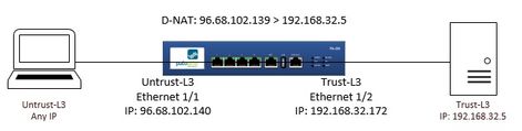

I have a test going, but confused about how my web server is translating its source address when replying.
I thought that I would have to create a bi-directional NAT rule to get the web server to change its IP back to public (after the D-NAT), but that's not the case.  It works with just a D-NAT rule.
How is the source IP of the web server switching back to a public IP on reply?
This is my goal and current configuration.

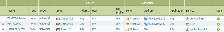

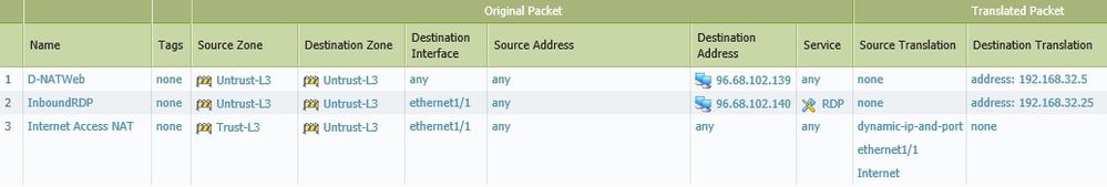

Rules:

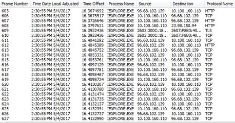

Client (behind a NAT) on the internet.  I can see the source must have changed back to the public IP.
I can see when it leaves the Web Server it is still the private IP as source, but must change to public at some point.
  • I thought that I would have to create a bi-directional NAT rule to get the web server to change its IP back to public (after the D-NAT), but that's not the case.  It works with just a D-NAT rule.

Yea, I can understand if you are using the one public IP, but I am using a different one than the one for my general internet connection.  I do have a range, but using two of them in my example.  One for general internet usage and the other for my web server.  That's why I am confused.  It's successfully changing its source IP when leaving the firewall, but without the need for a bi-directional S-NAT rule.

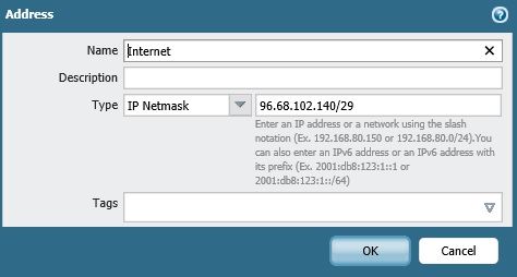

Do you mind showing your 'internet' address object's subnet mask? I suspect you've added this in as a network and therefore the firewall has a pool of IPs to use for source NAT.
Ben
Yes, I did configure my internet address with a subnet bit mask.
Does that explain how it knows to change the source IP back?
