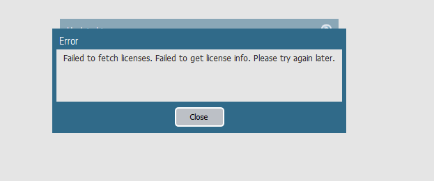

Techs,
I am building a OSS device in parallel to the production one. While uploading the Apps and Threat DB manually I was getting a license error. Hence I tried to install the Apps and Threat license I am getting the error "Error installing license key. Please check if it is a valid key ". I have downloaded the key from paloalto portal itself, its a *.key file.
This device is not connected to the Internet.
How can I fix this license issue?

Hi Kiwi,
I was following the same link you have posted. Now the OSS PAN OS version is 8.0.0. As per the upgrade path I have to flash this with PanOS_3000-8.0.0. While flashing it gives me the error related to 'required a content version of 769 or greater and found 695-42002'.
Hence I have downloaded the 'dynamic updates' from the portal named 'panupv2-all-contents-8214-5792'. But while installing the contents its giving me the error code 'no valid threat prevention license'.
To fix this error, I am trying to install the licenses that I downloaded from portal in *.key format. But resulting in the subject error.
Note: This is a new OSS device, and currently its not connected to the Internet. I am trying to make the OSS PAN OS Version as similar to the production one so that I can import and export other settings from live to OSS.
Sabin
I have tried inputting authorization code as well instead of uploading the license file. Getting error "Failed to fetch licenses.

hi @sabi4evr_com
you can't put licences on an OSS device as it is designed to be  'swap in place and adopt licences from donor', you need to make sure you download the apps-only version of the content file, it will be named something like panupv2-all-apps-xxxx-xxxx
that will install flawlessly on the OSS and then you can go ahead with the PAN-OS upgrade
hi @reaper
A big thank you.
I followed your advice, finally I flashed the OSS properly and is version is now parallel to the production.
