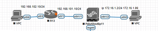

Does anybody encounter arp problems in eve-ng on palo firewall with pan-os 11 version ?  As an example, i have a small topology like clientA->routerA-> firewall<-routerB<-clientB , when i try to ping from clientA to clientB, clientA send ARP Request for clientB however firewall does not reply ARP Reqest... (it is not a policy,routing or config issue) i believe something can be wrong with my firewall image. (if clients direcly conneted to firewall without routers then it works)

vpc1 : 192.168.102.10/24  (gateway 192.168.102.1 on router)
eth0/2 : 192.168.102.1/24
eth0/1 : 192.168.101.1/24
firewall eth1/1 : 192.168.101.10/24
firewall eth1/2 : 172.16.1.2/24
vpc2 : 172.16.1.99/24  (gateway 172.16.1.2 on firewall)
From VPC1 and Router i can ping firewall interface eth1/1
From VPC2 i can ping firewall itnerface eth1/2
However from VPC1 i can not ping VPC2, even though there is route for network 192.168.102.0/24 on firewall default virtual router exist. It does not reply ARP Reqest packets comes from Router ( started ping from VPC1)
