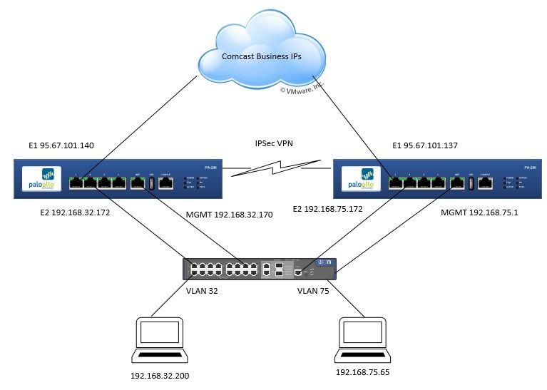

Thanks folks for all the feedback.  I now understand better and can see where I was confused a lot.
First, I did not understand that I was in the context of the management interface using SSH when I was unable to ping my public IP and needed a gateway entry there.  Which is totally separate and unrelated to the IPSec tunnel being up or down.  I needed to run the test vpn commands to generate the interesting traffic.  You guys were trying to tell me that, and I was not getting it yet.
I am attaching my diagram for now and close this thread.  I may come back and attach my firewall config.
