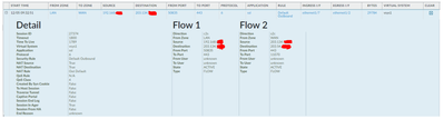

Below is the detail session view of the session when the download froze.

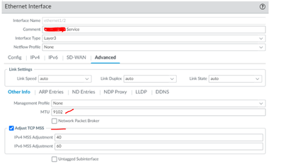

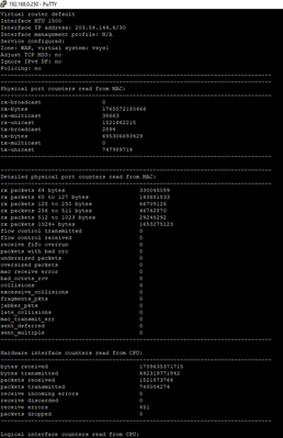

Below is the interface output for 1/2:
The ehmon, brdagent etc logs are all fine (no sign on hardware issue)

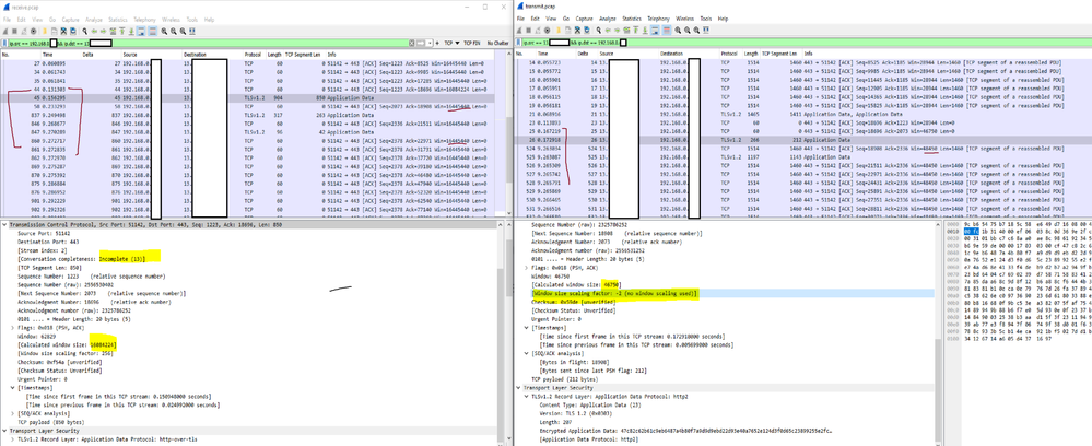

You've verified that MTU, speed, and duplex are all setup properly for the new ISP? The next step after reviewing that and logs would be to take a PCAP and see if you see anything out of the ordinary there. From what you've posted it looks like the session is staying alive on the firewall side of things, so I'm assuming that you have some ISP issued equipment on-site as well.

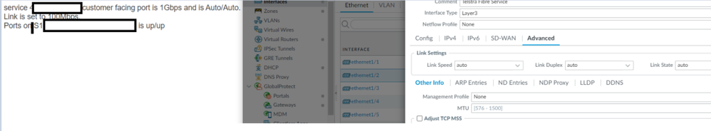

Below is what I found: Looks like the ISP side link is 100Mpbs and Interface in PAN connected to that router is auto.
I want to know if PAN Is set to auto and the other end is 100 will that not negotiate automatically? I have not tested yet but do you suggest i change the PAN side to 100 too?
Interesting, from the captures what i see is the windowing size is different in the Rx and Tx stage as below and the the sequence no has a exceptional difference:

When it comes to speed/duplex, both sides must have the same configuration. If yours is set to Auto and theirs is set to 100/full, the devices will drop to 100/half. However since you connect a laptop to the same interface from the ISP and it works just fine, I doubt this is the issue, but worth a check.

Changing the port on FW to 100mb/sec actually broke the connection (Performed a Hard reboot prior to that). Tried enabling flow control with no luck and I also verified remote is not sending any pause msgs. Have even enabled jumbo frames but all in vain. Traffic is not at all overloaded, has less than 10 users. The policies have no sec policies/filters and it's a flat network. What could I be testing next?

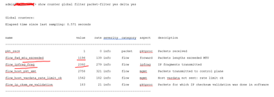

The global counter for packet filter was as below and changing the interface values for MTU/TMSS also yielded no difference. Could this is an HW issue?
note: no profiles / QoS / etc used and MTUs are also aligned
when the testing was done, the download just got stuck after some time and never resumed.
However, MTU and ipfrag counters increased.
