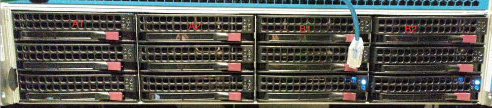

Hey all,
I need to replace a disk on a Palo Alto M600 log collectorScreenshot 2022-01-12 at 11.09.51.png There are no disk labels on the device. Could anybody here confirm which bays are A1/A2 and B1/B2? I've attached a photo. I'm guessing A1 starts the top left but I' not sure.
#m600
As per M-200 they are from left to to right A1/A2/B1/B2 so the same should apply for M-600 as you have shown on the picture.
It should be from the left One After another as they are in 2 disk raid (a1, a2, b1,b2):
M-600 Appliance Front Panel Description (paloaltonetworks.com)
Log Collector RAID Disk Settings (paloaltonetworks.com)
Ive added where I think A1 & B1 might be. Could you confirm?
