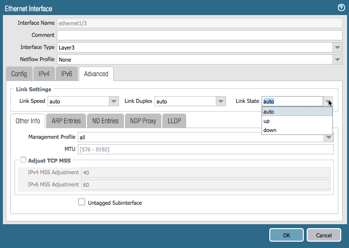

Hi Jasper
it looks like the interface has been set as 'down' manually
make sure the link state is set to auto or up:
