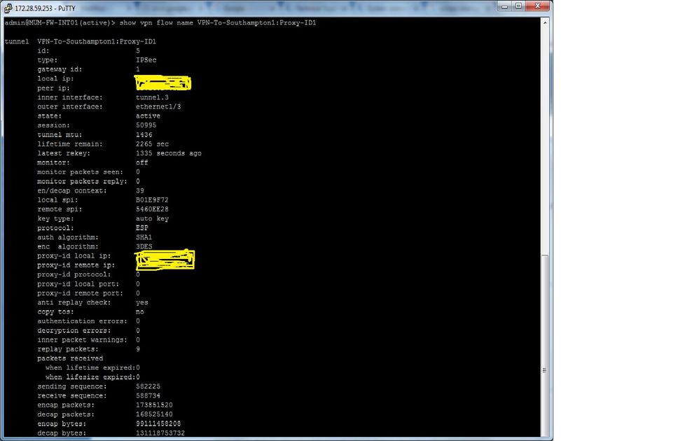

Run the command 'show vpn flow name <value>' and post the output.

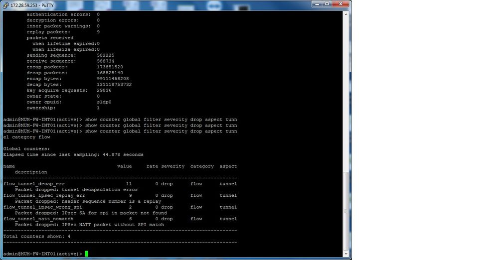

May also want to verify global counters with the porper filters on both ends to see if there are any errors or discards. 'show counter global filter severity drop aspect tunnel category flow'

Can you run show global counters for erros and drops? That will give you evidence about the type of drops in the firewall and possible cause.
Thanks for reply , Please find the below "show vpn flow name <value>" and  'show counter global filter severity drop aspect tunnel category flow'  command output.

The only thing that really sticks out on any of that too my eyes is that fact that you have 9 replay packets. How exactly have you identified that you are dropping the packets on the tunnel? Have you taken a PCAP on both ends to verify that the end device in question isn't dropping the traffic?
