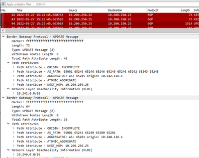

So with a capture I can see my route getting sent in the update message. In fact, I see a second route 10.242.0.0/16 that is accepted and placed in the fib. However the 10.240.0.0/16 seems to be rejected. Next hop on both destinations is the same. The suggested logs did not produce any insight to the cause.
10.200.250.26 - is the PAN
10.200.250.25 - is the DMVP peer

Unfortunately I also not able to explain what "reject by policy" means, but looking at the two screenshots you provide it seems the prefix is rejected because of the BGP loop prevention:
- From first screenshot it seems that PAN FW is using ASN 65200
- From the packet capture screenshot you can see that 65200 is part of the AS PATH advertised for this prefix. BGP loop prevention will reject any prefix when it sees its own ASN in the path. You can see that for 10.242.0.0/16 FW ASN is no in the AS PATH, therefor it is accepted.
If you are absolutetly sure that you need to accept this prefix, even if FW ASN is in AS PATH, you can tell the firewall to remove specific AS from the path with Import rule. That way BGP loop prevention will not kick in and will accept the route. The following link gives example how to configure Import rule that will remove ASN https://knowledgebase.paloaltonetworks.com/KCSArticleDetail?id=kA10g000000ClEkCAK In the example they use regex, that will remove any of the two ASN, but in your case you can simply remove only 65200
I do see the PAN AS in the path for 10.240.0.0/16, didn't notice that as it is not expected. The 10.242.0.0/16 route is learned from the same neighbor and is just another route same as the 10.240, the PAN AS does not show up in this one, odd. Both routes are out the same interface and are NOT learned from any other peer.
Why would the PAN place it's own AS here?
Thanks for the help Astardzhiev
The PAN didn't place it's own AS in the path, that was inserted along the way. It looks like 10.240 was originated by AS 65201, which peers with AS 65200. Is there another 65200, or another device besides the PAN in 65200?
One of my peers did remember another site using the same AS. Didn't even know it was there. Thanks for the help
