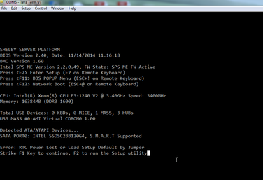

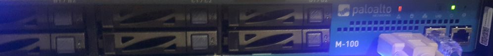

Hi, I have a Panorama M100, the device lost connection, neither couldn't be access by console, so we don't make any changes. Then we reboot and connect keyboard direct to appliance and we choose option F1, whit that, the device Started working and recover the access, but now the device show up a led red alert. that it means -- System Health Indicates overall system health. Green indicates healthy, red indicates a system error. --
Anyone tell me what can i do? could be a case for RMA?

Very possible. Check the hardware state:
> show system state | match alarm
> show system state | match power
> show log system
 Don't forget to get a tech file generated from the device.

Yes, i have the tech support file, but in the PANTS, i don't see much information, I will generate the output for the commands and then will share with you

Hi, here is the output, I didn't see anything relevant, but maybe you find something

Thanks. Could not find any "true" alerts or errors. Can you open a TAC case or maybe someone else can help who dealt before with Panorama appliances.

I opened a case, and attached the tech support file and the commands that you told me to execute (show system state and show log system), so with that, they tell me that the device going to RMA. They didn't give me more information
