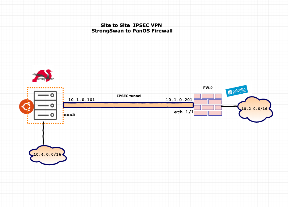

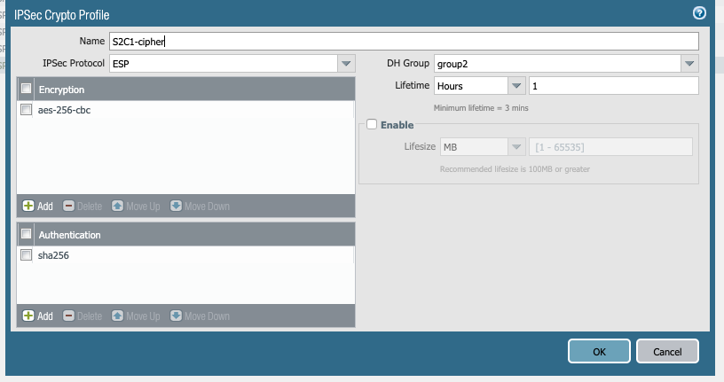

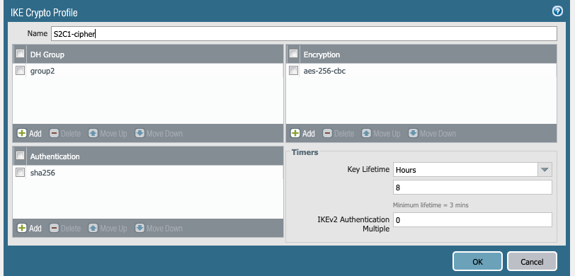

i got it to work for this topology - between 10.1.0.101 and 10.1.0.201i got it to work for this topology - between 10.1.0.101 and 10.1.0.201v2 worked for me , v1 implementation in SS seems to be flakyv2 worked for me , v1 implementation in SS seems to be flakyike and ipsec cryptoike and ipsec cryptoike and ipsec cryptoike and ipsec crypto

conn ubuntu-client-to-firewall #
  leftid=10.1.0.101
  leftsubnet=10.1.0.0/16
  right=10.1.0.201
  rightsubnet=10.1.0.0/16
  ike=aes256-sha2_256-modp1024!
  esp=aes256-sha2_256!
  keyingtries=0
  ikelifetime=1h
  lifetime=8h
  dpddelay=30
  dpdtimeout=120
  dpdaction=restart
  authby=secret
  auto=start
  keyexchange=ikev2
  type=tunnel
root@rithvik-gpcs-client-1:/home/rithvik#
