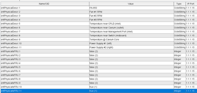

I am testing OID values ​​through PA-850 and MIB Browser.
When using ENTITY-MIB, basic hardware information appears to be retrieved as follows.
But what I need is Power Supply status.
I tested with the PAN-TRAPS MIB as shown below, but no value is displayed.
Example OID's attribute
.1.3.6.1.4.1.25461.2.1.3.2.0.911 Power Supply inserted
.1.3.6.1.4.1.25461.2.1.3.2.0.912 Power Supply removed
.1.3.6.1.4.1.25461.2.1.3.2.0.913 Power Supply failure
Is this function not supported in the PA-850 model, or is it an error in the OID value itself?
I tested it with the PA-850 and PA-3220.
As a result, it is confirmed that the entPhysicallsFRU value is confirmed, but enstateAlarm cannot be confirmed.
This feature has been confirmed to be supported only on the PA-7000, and Feature Requests for other products have also been registered, but are believed to be still under development.
