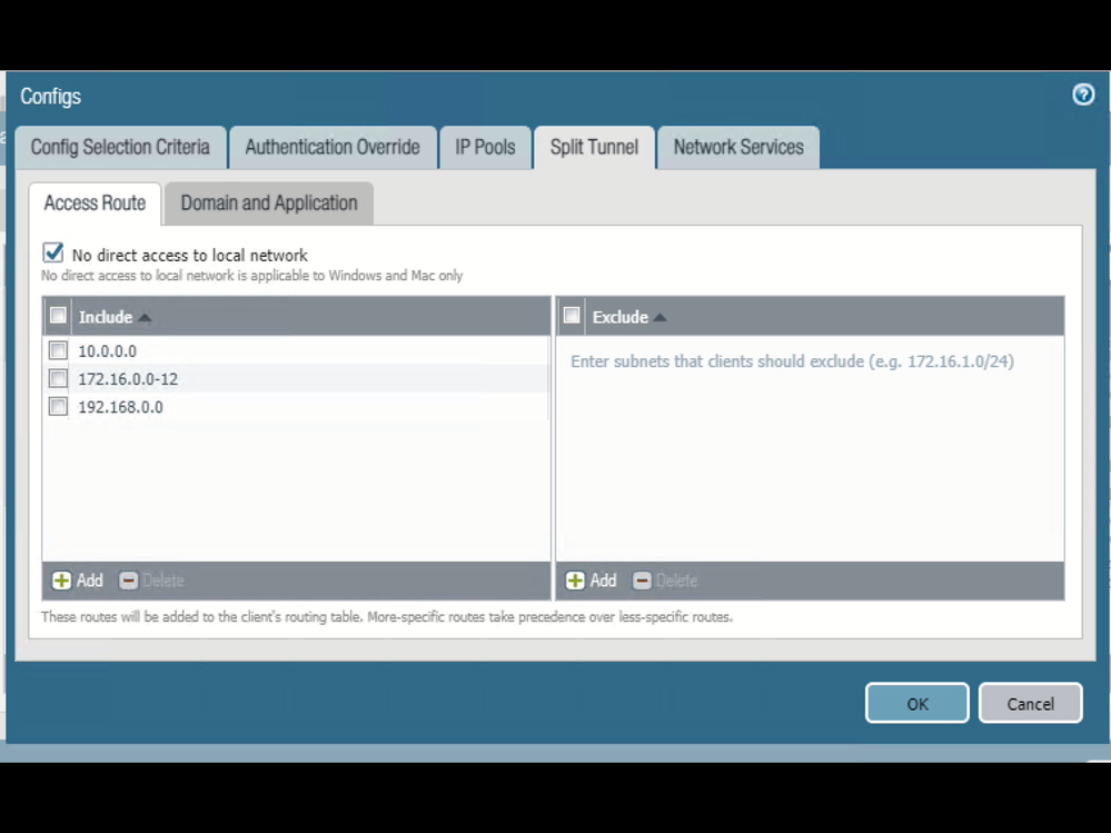

E99D6AD8-F220-49BF-8065-1604A454073C.pngNot sure what of what is causing your issue but we have this on a test gateway. We just include all rfc private nets by using address objects and exclude nothing....... and we only see traffic to private network addresses traversing the vpn.
I assume you are not using a proxy???

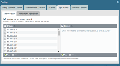

OK, so I removed the 0.0.0.0/0 and I checked that box.
Internet Traffic is still trying to go through the firewall. Like I mentioned above, we use Cisco Umbrella. So prior to me putting that check "on" traffic would go through the firewall then hit Cisco Umbrella and be blocked. Now when I do it I get one of our firewall blocked screens, not a Cisco Umbrella block screen
Regarding no access to local cal net.. Well that was my understanding but with the config i posted i am able to admin my local router...
Ok are you refreshing GP after updating tunnel settings.. and can you post here split tunnel settings.
Also can you post a route print output...?
Yes I disconnect, and I go into my local user app data folder and delete certs etc.
