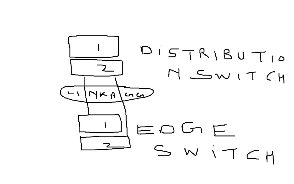

We have stack of 2 edge switch and stack of 2 distribution switches.
We have linkagg containing 2 ports running between them.
IT is layer 2 connection only between edge and distro.
Also we have MAnagement vlan on switch so that users can access it remotely
So for vwire
I will have two pair of vwires and i will need to have
4 zones and two security polices to traffic flows from edge switch to distro.
if i need to ssh to edge switch then traffic flow is via the distribution switch in that case i need to allow ssh rule from both vwires as i do not know PA will use which physical link right?

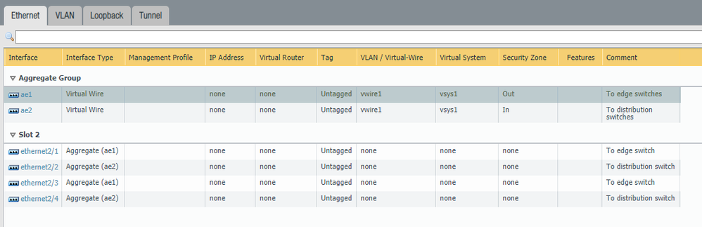

You could also have one vwire with aggregate Ethernet interfaces:
Each option offers some advantages and disadvantages of course, and may or may not work for your situation.
Since your devices are using link aggregation, have you considered adding your vwire interfaces as an aggregate interfaces as well?
