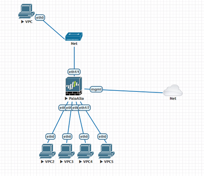

OK, so I made this topology, Layer3 WAN interface, Eth1/4-7 Layer2 interfaces, VLAN100 SVI.
Here's the config...
Interface config:
set network interface ethernet ethernet1/1 layer3 ip 10.0.0.2/30
set network interface vlan units vlan.100 ip 172.16.15.1/24
set network interface vlan units vlan.100 comment "Home Network"
set network vlan home_network virtual-interface interface vlan.100
set network vlan home_network interface [ ethernet1/4 ethernet1/5 ethernet1/6 ethernet1/7 ]
set network virtual-router default interface [ vlan.100 ethernet1/1 ]
Routing:
set network virtual-router default routing-table ip static-route default path-monitor monitor-destinations default enable yes
set network virtual-router default routing-table ip static-route default path-monitor monitor-destinations default source 10.0.0.2/30
set network virtual-router default routing-table ip static-route default path-monitor monitor-destinations default destination 10.0.0.1
set network virtual-router default routing-table ip static-route default path-monitor monitor-destinations default interval 3
set network virtual-router default routing-table ip static-route default path-monitor monitor-destinations default count 5
set network virtual-router default routing-table ip static-route default path-monitor enable yes
set network virtual-router default routing-table ip static-route default path-monitor failure-condition any
set network virtual-router default routing-table ip static-route default path-monitor hold-time 2
set network virtual-router default routing-table ip static-route default nexthop ip-address 10.0.0.1
set network virtual-router default routing-table ip static-route default bfd profile None
set network virtual-router default routing-table ip static-route default interface ethernet1/1
set network virtual-router default routing-table ip static-route default metric 10
set network virtual-router default routing-table ip static-route default destination 0.0.0.0/0
DHCP config:
set network dhcp interface vlan.100 server option dns primary 1.1.1.1
set network dhcp interface vlan.100 server option lease unlimited
set network dhcp interface vlan.100 server option gateway 172.16.15.1
set network dhcp interface vlan.100 server option subnet-mask 255.255.255.0
set network dhcp interface vlan.100 server ip-pool 172.16.15.14-172.16.15.254
set network dhcp interface vlan.100 server mode enabled
Security zone setup:
set zone home_network network layer3 vlan.100
set zone internet_uplink network layer3 ethernet1/1
set zone home_network_l2 network layer2 [ ethernet1/4 ethernet1/5 ethernet1/6 ethernet1/7 ]
Security poilcy:
set rulebase security rules home_network-outbound to internet_uplink
set rulebase security rules home_network-outbound from home_network
set rulebase security rules home_network-outbound source 172.16.15.0/24
set rulebase security rules home_network-outbound destination any
set rulebase security rules home_network-outbound source-user any
set rulebase security rules home_network-outbound category any
set rulebase security rules home_network-outbound application any
set rulebase security rules home_network-outbound service application-default
set rulebase security rules home_network-outbound source-hip any
set rulebase security rules home_network-outbound destination-hip any
set rulebase security rules home_network-outbound action allow
NAT policy:
set rulebase nat rules home_network_nat source-translation dynamic-ip-and-port translated-address 10.0.0.2
set rulebase nat rules home_network_nat to internet_uplink
set rulebase nat rules home_network_nat from home_network
set rulebase nat rules home_network_nat source any
set rulebase nat rules home_network_nat destination any
set rulebase nat rules home_network_nat service any

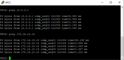

VPC2 and VPC3 successfully ping VPC host out on the WAN:
VPC3 and also ping VPC2 on the VLAN:
...obviously change the WAN Eth1/1 IP and all references to suit your own topology.
