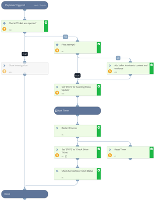

I was having exactly this issue, I wanted to loop a sub-playbook that prompts our analysts to check the Service Now tickets for updates to an XSOAR incident.
I created a playbook following PA's video HERE, and then found there is a command !resetTimer you can run in the playbook after the playbook continues.
This works and allows the playbook to loop and re-use that same timer.
