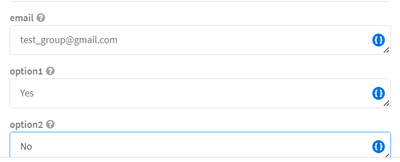

I use emailaskuser automation.
I use the buttons to get a confirmation.(Yes/No)
Let's say there's a mailing group that I'm mailing to.
I would like to see it in context, let's say [email protected](in this mailing group.), whoever responded to me via e-mail from here.

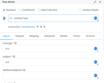

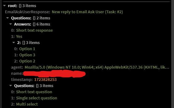

I put together a quick playbook with a few different question types to see how the responses are formed.
What data did you get back? When I tested this, the "Questions.Answers.name" key came back with the email address that I used in the "To:" field.
If that is the same for you, then I believe you are running into a limitation of the Email Ask User task and expecting multiple responses from a group mailbox/single email address.
