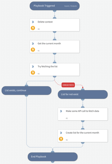

Hi @bowesmana, I've attached a short playbook that should work for your requirement. We have an automation called TimeComponent that will work better.
In my example, I've created the error path feature instead of a conditional check. I think you might be able to use the playbook as-is, ensure that you replace the "Make some API call.." step with the actual steps for fetch the remote data.
Note: Just rename the attached file from .xml to .yml.

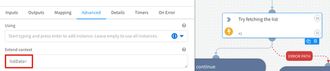

Thanks @jfernandes1 - something I don't get (I'm a real newbie) is having done getList and the list is loaded, where does the list data actually go? If I turn of quiet mode, I can see the data logged, but I can't see it in the context of the playbook, so how do I actually use it?  I think that was why I went down the ${lists.xxx} logic as I could put that in a Set automation and get the data into the context - with this method above, after the getList builtin runs, I don't have the data anywhere I can see.
Hi @bowesmana, by default nothing is written to context. You can keep quite mode enable and add the below to the advanced tab.
Do not add anything after the equal sign (=). The syntax tells XSOAR to grab all output and add it to the listdata key.
I would also like to recommend that you have a separate step for the getList command that saves the data to the context. Before you start adding more data to context, I would suggest that you only do so:-
 - When you cannot use CompareList or FilterByList commands
 - When you cannot use a conditional playbook task with the In, Not In, In List or Not in List operators.
