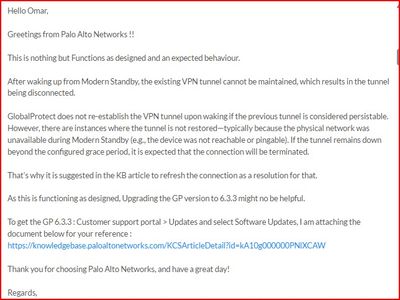

The connection to internal resources is via VPN through a policy in GP. We have deployed GP on SCM, not on the firewall. We have reviewed the logs and TAC has reviewed the evidence we have sent them, but they only give us indications that it is a problem with the power process of the endpoints when they hibernate.
Here is the lastest TAC response.
When I mentioned "Look at the GP logs on the firewall" and when you say "We have deployed GP on SCM, not on the firewall." we're both saying the same thing.  You might have "deployed" the Global Protect VPN service via Strata Cloud Manager (An orchestration tool) but all that is, is a view into a virtual cloud hosted Palo Alto managed FIREWALL...it's still a firewall.
The note you've shared from Palo TAC is something similar I've extensively troubleshot within my organization.  Are you using Lenovo laptops by chance?  We had a lot of issues with both the wireless network adapter on Lenovo laptops having stability issues that needed driver updates to solve our "VPN problems."
What looked like a "GP problem" for us was a hardware/driver issue on the wireless network adapters across tens/hundreds of laptops.  Looking through our GP logs TAC was also able to identify power adapter/sleep issues of our laptops that was interfering with the GP software functionality.
You originally mentioned that users are online working then "all of a sudden they disconnect."   TAC mentioned power changes in the clients.  When your clients are having issues are they stationary & connected to a docking station?  Maybe try updating both the laptop firmware (drivers) as well as drivers of the docking station itself?
