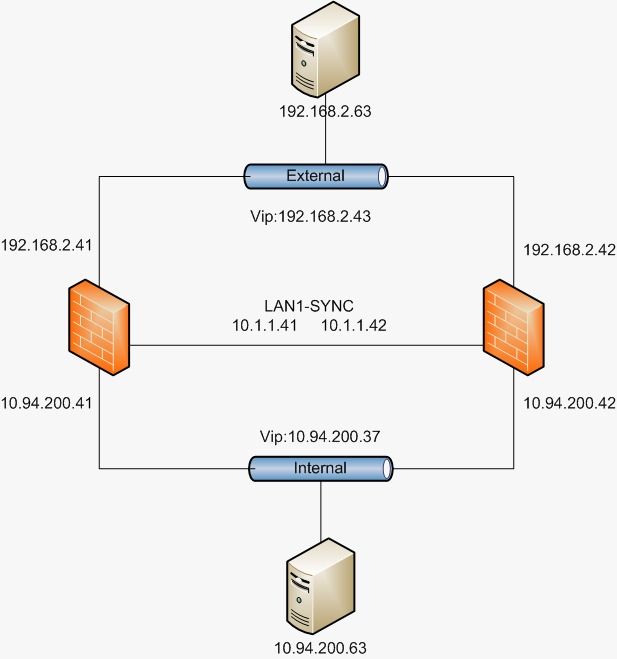

Hi @BPry , Thank you for reply me. Let me send you an example.
41ddf78f-2a31-45dd-81d6-9b5ebc824fa4.jfif
In current network topology, it look pretty similar to this. And I think you misunderstand something here @BPry . Because with HA Cluster, there is no Passive. All member is always Active but they can also be a part of HA Pair where we have Passive. You can check this document.

For the example that you sent over, are the two firewalls that you actually have referenced actually just two firewalls or two separate pairs? It sounds like you're just talking about having two standalone cluster members? If that's the case you won't gain anything by deploying clustering over a simple Active/Passive or Active/Active deployment.
Hi @BPry this is the current firewall topology i have with 2 Check Point firewall and it will be replace with 2 PA 5250. With Check Point Cluster it can be Active Ative or Active Passive base on your decision. And each firewall stay in a difference DC. Let say FW1 place at DC1 and FW2 place at DC2. DC1 and DC2 is in the same city but still far form each other. The sync interface between 2 firewall is 1Gbps Fiber cable connect between 2 DC. Now when deploy new PA firewall, if using HA pair i'm not sure HA1, HA2, HA3 can use 1Gbps link or it have to be 10Gbps link which not available to me right now. So i decide to use HA Cluster where HA4 can use 1Gbps link, it also design for HA between 2 DC.  But i have no idea how it work, it will have a virtual IP between two cluster member like Check Point Cluster or else. Please help share with me about this. Thank you.
