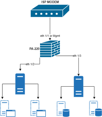

Also for the internet to PA-220, can I connect ISP Modem directly to PA-220 and configure public IP on either management port or one of the interfaces?
Something like below is what I want to achieve. Is it viable?
Sorry to ask some basics but I am a bit new to this.

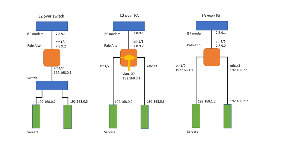

Hi @PranamShah ,
Yes, it is viable.
  1. You can connect the ISP directly to the PA-220.
  2. You can connect your servers directly to the PA-220.
  3. Set the ISP interface to L3 in a L3 untrust zone with the public IP.
  4. Set your server interfaces to L2 in a L2 zone.  Put them in the same VLAN.
  5. Create a L3 VLAN interface tied to the L2 VLAN in a L3 trust zone.
  6. Create default route to ISP.
  7. Create DIPP NAT rule to outside interface IP from trust zone to untrust zone.
  8. Create security policy rule to allow traffic from trust zone to untrust zone.
Tom
