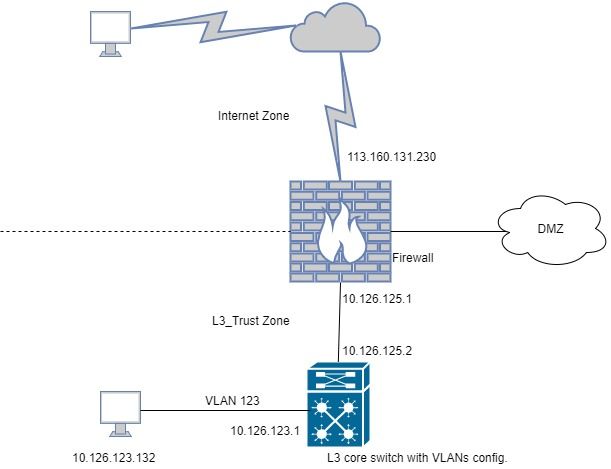

Hello all,
I wanna Remote desktop from my PC in home to PC in my company but not success
This is my connection diagram
I wanna remote to PC 10.126.123.132 (belong to VLAN 123, I use several VLANs in Core switch) but not success, NAT seems not to work, there's no traffic logs

I can remote from internet to a server in DMZ zone successfully but L3_Trust zone, so I think because of using VLAN in core switch, it requires some other config.. Please help me 🙂

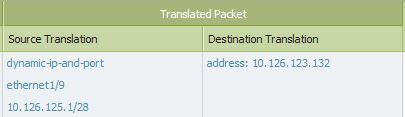

In your nat rule try adding source nat 10.126.125.1.
your dmz may have a default route to the internet but maybe your vlans dont.

If that is not the case then , check the routing on the switch. For testing in the nat rule that you have created for inbound, source nat the traffic to the trustzone interface.

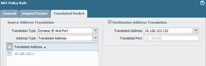

Thank you all for your help, I added source translation to IP of L3_Trust interface (10.126.125.1) but still not success when Remote Desktop 😞

Try modifying your source translation
address type = translated address
translated address = 10.126.125.1

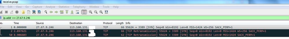

Thank you Sir, this is the picture of recive.pcap and drop.pcap, there's nothing in transmit.pcap and firewall.pcap. I'm sorry, due to security reason, I'm not allowed to upload capture file here
27.67.9.246 is my public IP from internet zone
I also run command show session all filter source<your_public_src_ip> destination 113.160.131.230 destination-port 3389 but there's no active session
I change the source translate to "translated address" but it still not working

Of cource it wouldn't work...When using destination NAT, Security policy must contain PRE-NAT addresses and POST-NAT zones. Which means that your original configuration configuration is actually correct.
In my humble opinion your original configuration was correct (correct NAT and correct security policy). There was suggestion to set source NAT and I saw you have enabled source and destination - I would say this is wrong... I believe the suggestion was to configure source static nat and enable bidirectional. That way you should accomplish the same think create static NAT. But you shouldn't enable both source and destination in the same rule.
In the capture you can see that drop capture is filling with with the SYN, so
