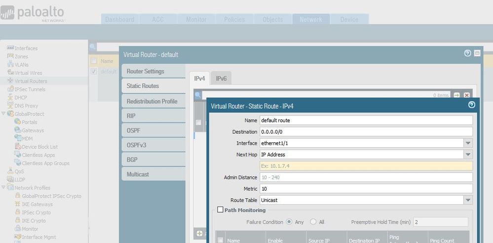

Palo has a Virtual Router concept:
https://www.paloaltonetworks.com/documentation/60/pan-os/pan-os/networking/configure-a-virtual-route...
It has to be attached to the interface
you would configure the assigned virtual router to have a static entry of 0.0.0.0/0 and point it to the outside/untrust interface and assign the next hop
CCNA Security, PCNSE7
thank  you on that i think ive found it
