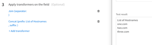

Thanks @jfernandes1 I ended up writing a short Python automation - in your solution it joins the rows into a single row, but I wanted the host on a new line, so I can effectively export that as a file that others can load into a some tool to view, it has around 10,000 entries so not useful on one line.

Hi @bowesmana, in my previous example, you can swap the ArrayToCSV for the Join transformer. In the Join set the delimiter to the enter or return key. This will add each entry on a new line.
