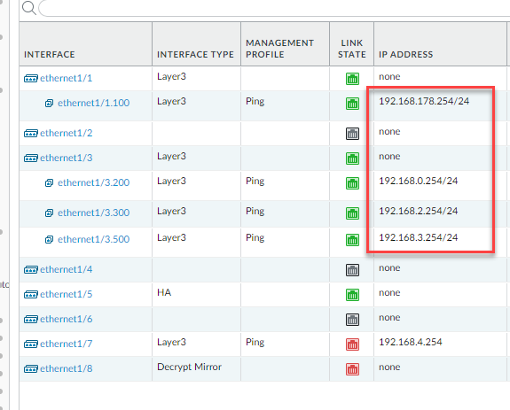

Indeed! It seems this here was the problem! I only had 192.168.0.254 set as the IP address, not 192.168.0.254/24.
Is it then explicitly assumed to be /32? But why did everything else work? Just because I had the VirtualRouter configured correctly?
@daubsi,
Glad to know that your issue is resolved!
Yes, if IP address is configured w/o a subnet mask, it will consider it as /32 and firewall will add route for /32 host in its route table. If the same interface is configured with subnet mask let's say /24, firewall will add route for that host and also route for the whole network of 24.
Now in your case, there are chances of having static route for network 192.168.0.0/24 under your VR and that's why everything is working.
