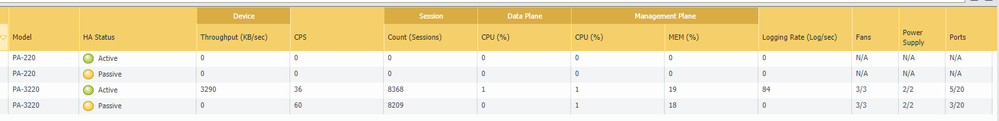

After I uprageded all PA firewall and Panorama to version 9.1.5. My PA-3220 is working properly but not for PA-220.
The operation is working fine but health information on Panorama for PA-220 is missing as capture below
Infomation like CPS,session, CPU utilization and etc.. are missing but connectivity between PA-220 and Panorama is seem good.

Hi@MP18
I can see traffic log coming from PA220 in Panorma.
I have tried to restart the management server on the PA220 but still no luck

Restart the mgmt server on PA-220 is working. Just take some time before it is working.
Thank you for your help @MP18
It is so annoying. It happened in all release in 9.1.x for PA-220. Over 90% of my devices got this problem during PANOS upgrade. I reported to PA support over a year ago and the problem is still existed until now (9.1.11).
