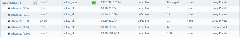

So up to this point I'd only been using tagged sub interfaces for capacity\housekeeping\etc,  so they were all in the same security zone.  Now I have a case where I'd like to be able to add some rules to where traffic from this new VLAN can go..
I put the new sub interface in a new zone,  add the new zone to the general internet access rules and outbound NAT rule..  no love..  So I look in at the traffic monitor, I see the traffic but it has a source zone of the parent interface, not the zone it is configured with..    am I missing somthing obvious here?

Hmmm.. No it says the are coming from the parent interface ethernet1/2.

I think I figgured out why this is happeing..  I have a Layer 3 core switch that sits in front of the PA and does inter VLAN routing.  The only route it has to the interwebs is it's default gateway which is the 192.168.10.2  address of the parent interface on the PA.   This setup works and VLAN traffic makes it's way to the interwebs.  If I remove the Tagged subinterface for a VALN from the config,  traffic for that VALN stops at the 192.168.10.2 interface.   To be 100% honest I'm not clear on WHY this actually works, tagged VLAN traffic is being forwarded to an untagged interface, perhaps it has to be with the way PA is doing the subinterface?   Anyhow,  I think for this to work the way I want it to, traffic from each VLAN needs to be forwarded to the subinterface.  The only way I can come up with to do this, and leave the core layer 3 switch doing inter VLAN routing, is to move to Policy Based Routing.
Hello @razor192,
Your text and screen shot Zones do not match up. If you haveyour source zone set as UnSecuteWiFi-66, you should be ableto create policies around that.

the 1st screen cap is a nonworking config..   the second screen cap is a working config
