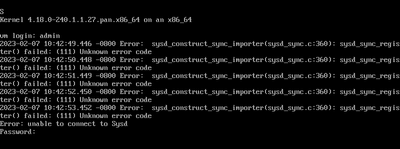

We got a customer that runs into this issue recently, it's a known issue (not public) for versions 11.0.0, 10.2.3, 10.2.2-h1 (and also to us 10.2.3-h2, 10.2.2-2).
When you run into this, means that there's a hardware issue, please go to TAC in order to find the root cause.
VM-series fails to boot on Hyper V with older Intel Xeon CPUs.
This is happening with Hyper V.
The solutions that we used to fix it are two:
  1. Revert to the previous version in maintenance mode:

I am running into the same issue with the PAN-OS VM-Series Base Image for PAN-OS 11.0.
It may very well be that this issue is related to the CPU(s) powering the hypervisor and not that the issue is specific to Hyper-V.
In my case, the CPU is indeed an older Intel Xeon processor, but I am running on VMware ESXi - not Microsoft Hyper-V.
VMware ESXi 6.7.0 Update 2 (Build 13981272)
ProLiant DL360 G7
12 CPUs x Intel(R) Xeon(R) CPU E5649 @ 2.53GHz
 @Gabeeh  I tried following your recommendation. I booted the VM into the maint partition and tried performing a factory reset. This is a net-new VM-Series build.
I've also tried upgrading an existing VM-Series running 10.2 to version 11.0 and get the same error message as soon as I try to login as user 'admin' from the console.
I've included a copy of the log from VMware ESXi in the event it can provide anything useful in support of the known issue.
The network interface seems to have initialized and I can ping it, but neither SSH nor HTTP/HTTPS are listening, so I am unable to login via the network.
Do you happen to know if this is an issue that will be resolved? Or will the older CPU simply no longer be supported?
Thanks in advance!

Today, PAN-OS 10.2.4 and 11.0.1 were released and this issue is addressed in these versions:
PAN-206069
Fixed an issue where the firewall was unable to boot up on older Intel CPUs.

Might be unrelated but I'm currently deploying some VM-Palos (11.1.4-h1) in Google Cloud Platform (Intel Cascade Lake).
They were working fine, 3rd party asked me to swap the Management interface from eth0 to eth1, ran the command, restarted and they were ok.
Rolled the change back, restarted them and when they came back up I was getting the same error as the original poster when trying to login (via console)
Stopped the VM from the GCP console, started the VM and it started working again
