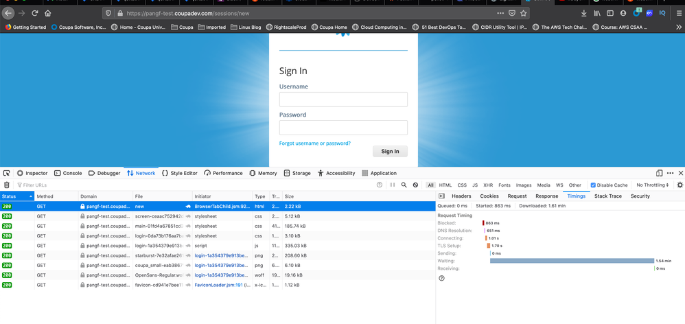

We have deployed vm-series 300 in AWS recently and put our production site behind it, but we are seeing a performance degradation, the website is taking around 2-3 mins to load for the first time which normally it didnt take, we have not put any url filtering profiles yet but yes we do have some security and nat profiles in place(which normal I believe), I just wanted to understand what could be the reason for the slowness and what all things can be checked in PA to troubleshoot.
PS: I am attaching a screenshot of developers tool console to show time it takes for the page to load first timeScreenshot 2021-04-12 at 11.29.58 PM.png

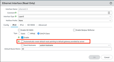

Also watch that you do not have "Automatically create default route pointing to default gateway provided by server" enabled on both of your interfaces.
I am sure of the second point you have mentioned, no we did not do that.

see below on the picture. You have to make sure that on the interface on the firewall are you not select "Automatically create default route....."

Yes, we have not selected this for the trust interface

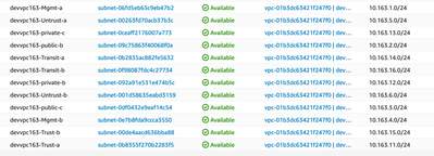

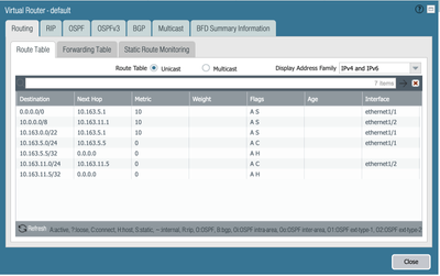

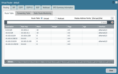

10.163.6. and 10.163.5 are untrust interfaces(subnets) and 10.163.11 and 10.163.15 are trust interfaces

What subnets are your LB and back in?  The route that I question is the /22 on only one of the firewalls.  If you have backend traffic that is not in the same subnet as an interface, you could be routing it out Eth1/1 but snatting it to Eth1/2.  That will cause a timeout.
On the flip side, you have a 10/8 route via eth1/2, this is going to prevent your LB health checks from return to the cross zone subnet via eth1/1.
You should have 0/0 via eth1/1 and static route for the NLB subnets also via eth1/1.  You can then use the 10.8 route to get to all other subnets via eth1/2.
