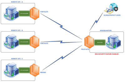

We have a site-to-site hub and spoke vpn setup, Palo Alto being the hub and multivendor spokes.
Is it possible that our remote sites are able to utilize the DNS Security feature installed on Hub for DNS Sinkhole?

Hi @popoymaster ,
Then you would need to at least back haul all DNS requests from remote sites to the hub.
Tom
Hi @TomYoung ,
This is the part we want really full understanding, so pointing users DNS Server to Palo Alto interface?
Will Palo Alto acts as a DNS Server?
Wendell
Hi @popoymaster ,
It is sufficient for the DNS traffic to go through the PA.  You can configure the remote sites to use the DNS servers at the hub.  It is very important that the Anti-Spyware profiles are applied to the traffic.

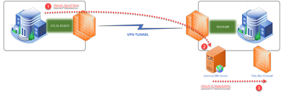

@ozheng,
That is what exactly we want to implement, to push the traffic from remote sites going to the HUB, and let the Palo Alto do DNS Sinkholing (Licensed).
So my question is how? I am thinking to provision a DNS Server in the HUB, then that DNS Server push the DNS Query through PA for inspection.
Wendell
ok @popoymaster
I don't see any issue then.
You make sure the traffic is going to the Central site (static default route or advertising the default route over some routing protocol between the central site and the remote sites)
And you simply have to set the anti-spyware profile for the traffic (remote site> any) on the PANW firewall.
The DNS Sec is configured in the anti-spyware profile.
Also if you have read the link I shared earlier, you may take measure regarding DoH and DoT.
Olivier
Best Effort contributor
Check out our PANCast Channel

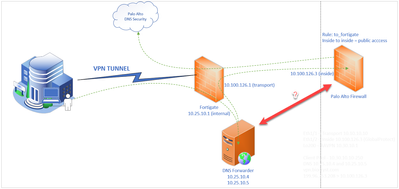

@ozheng ,
Our VPN concentrator is Fortigate, it has 2 vlans, Internal and Transport.
Internal where the DNS Server resides.
Transport is connecting to the Inside interface of the Palo Alto.
Now, how is it possible to forward the traffic from Internal DNS Server and point to Palo Alto for DNS Security Filtering?
