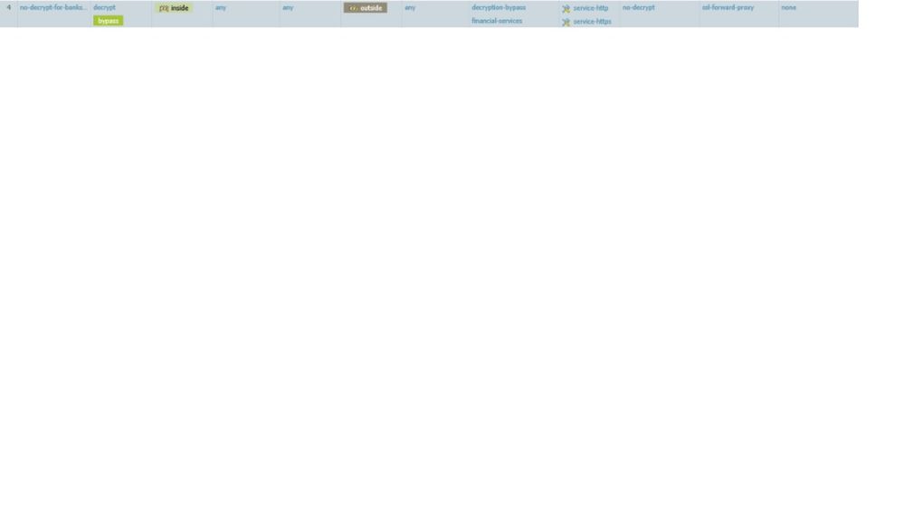

Tried using a simple test rule from Inside to Outside, Application any, Service/URL Category any, without any profile.
No NAT in use.
No-decrypt rule is in use for URL category: *.gov.au

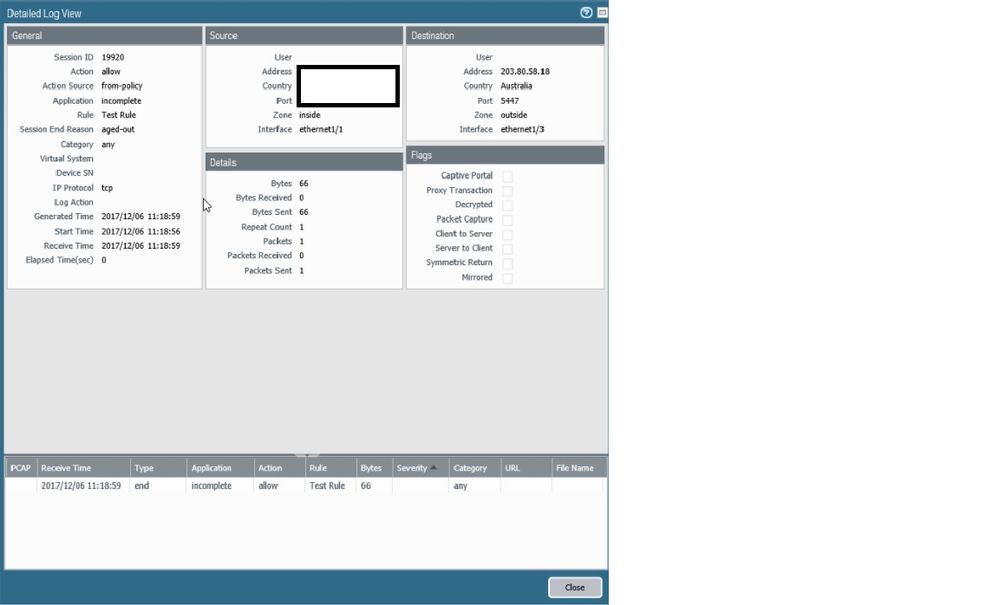

your log states the app is incomplete and there's only 1 packet sent, none received
you may want to do some more basic troubleshooting like a ping or traceroute to verify if your routing is letting you get to the server, and then perform more tests to see why you are not receiving a reply packet (is the conenction being NATed, is the port allowed to pass through the upstream router, is the destination server blocking your ip,...)

Agree with another comment here: your log shows that the flow is seen as incomplete with no ingress packets. I would assume a network architecture problem like assymetry or a NAT problem: you tell that there is no NAT policy configured... Even an outbound one ?
This issue only occurs when using a non-standard port 5447.
The Security policy is a simple one with application and service set to Any.
As mentioned earlier, no NATTing is there.

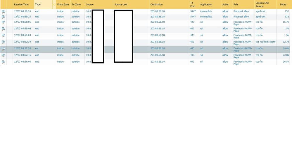

your outbound packets are being passed along so my guess would be there is an upstream issue
Since you're not applying NAT on the Palo Alto, is your upstream NAT device perhaps configured to NAT default ports (80+443) and not 'high' ports?
Can you show your "Pinterest Allow" Security Policy?  That's the one that's matching the traffic, as shown by the log entries.  And show the Security Policy that you think it's supposed to be matching.
@Farzana,
The current traffic is being allowed through the "Pinterest Allow" security policy, and prior traffic was being allowed through your test rule. Since your only test of this actually working is through a 4G connection, was that done through your Palo Alto or on a mobile device.
I think @reaper is right, this looks like it's an issue upstream from your Palo Alto. With the information provided I would start testing to see if you can access the site through the ISP connection if you bypass the PA all together, my initial guess would be that this test will fail. Once you've verified it's an ISP issue, then you can start the process of troubleshooting with the ISP.
