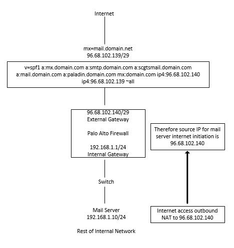

We changed our public ips recently and we have a few recipeints that are blocking our new mail IP.  I am suspecting has something to do with either our TXT (SPF) record or the fact that we are using a destination NAT rule instead of bi-directional.
I've included a diagram and notes below, but trying to get some feedback on what the problem might be and if there is a general best practice based on experience.
In general: I am thinking that we should make our NAT rule bi-directional so that it's source IP when initating to internet from mail server is the assigned IP rather than the general NAT IP/Port to the firewall interface.
Any comments or feedback?

Set up your SNAT and DNAT rules so that incoming and outgoing email would go out from same public IP.
Or set up SNAT as bi-directional.
Neither of those IPs you mentioned resolve to anything reasonable.
You have to ask your ISP to update reverse DNS record for the IP where emails are going out from.
Reverse DNS has to resolve to email domain.

While I would generally run SMTP servers with a bi-directional, this is far from a requirement. It really looks like you got assigned a bad IP. Go through Office's IP Delist process and get your IP removed from the Anti-Spam list; I bet when it gets removed you'll find everything works fine.
Many spam filters do reverse dns lookup and if IP does not resolve back to correct domain then they flag email as spam.
Ask ISP to update reverse dns information.
Bi-directional NAT would be simpler. Your HELO should match DNS in both directions, in additional be listed in your SPF record. It is also possible that your IP is blacklisted.

Yea, in our Exchange server there is a message:
"Client host rejected: cannot find your reverse hostanme [96.68.102.140]"
The Client here is one of our customers that is rejected our email.  The IP shown above is the outbound source IP based on our general internet access IP and port address, not the mail assigned IP of .139.
Does it still sound like just an ISP/DNS update problem?
I am trying to determine if our firewall rule needs to change, TXT record, or other.

Y'all were right.  Needed to create new PTR records with new ISP.  Once I did that, our TXT (SFP) is passing.
I also did change our Mail server NAT rule to bi-directional.
