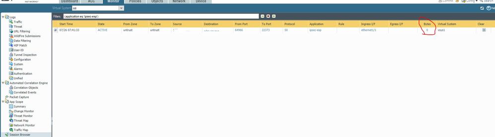

Also if you will check session browser tab, and filter based on the OSFP app, what can you see. I think it is something to do with the device own session. For instance, l am running an IPSec VPN that terminates on the PA, l also cannot clear this session as well as my counters 0 bytes:
EDIT: I'm not sure, though, if this is the case with OSPF
