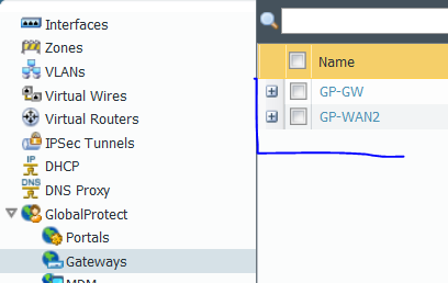

- I have gateways 01 and 02 for the GlobalProtect.

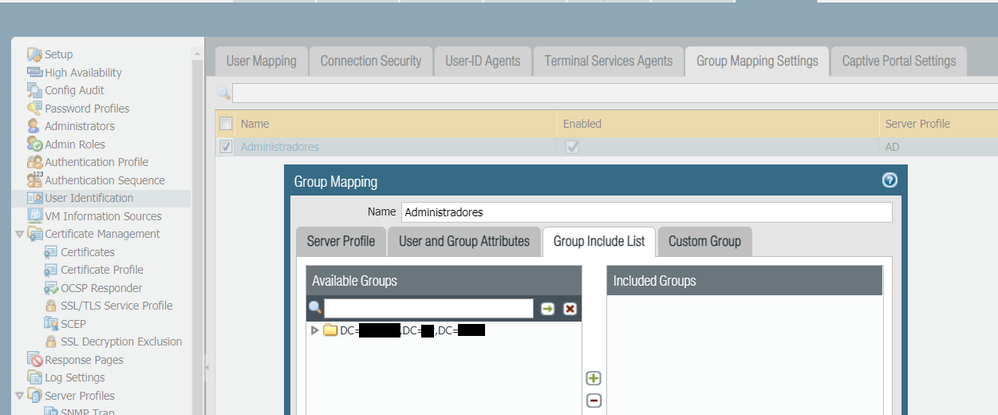

the group settings can be found in Device\User Identification\Group Mapping\Group include

you have not used the "Included Groups" option.
This will force the firewall to collect all information for every group within your AD.
The firewall has limits on how many groups it can access and although this may not be the issue here I would still only include the required groups that you actually need to interrogate. this will also help with future diagnostics when using multiple groups.
This will also allow you to use "show user group name"  and return valid entries.

Thanks for the tip with "Included Groups". It can be an interesting point for improvements and I will study the possibility of adjusting it!

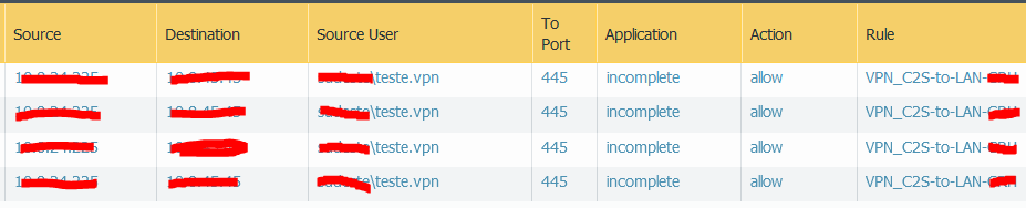

Even with the user having problems, I see the communication attempt, but the log is presented as the "incomplete" status.
@Amaro123  is the communication attempt you are seeing allowed or denied?   I would imagine that it's allowed or the sate would be not-applicable.  it may help if you paste log snippet.
Hello @Mick_Ball,
They are allowed, but in Application the status is "incomplete".

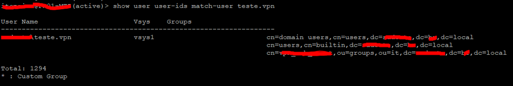

I used the command "show users user-ids match-user <user.name>" for the user who has been doing the tests and he recognizes the group I mention here in the example that presents the problem. In this case it is the third in the print list.

Having the above in mind and the logs you provide it looks to be like routing problem.
I am assuming that the two gateways are assigning different IP pools to the connected users, but do they assign different range based on the user group?
I can imagine that gateway01 and 02 are assinging differen IP addresses based on the group membership. So when user is assigned to Group2 and connects to gateway02 he is assigned with ip address that your internal network doesn't route properly. If you look at the log details (the magnifying glass on the very left of your log entry you sent earlier) you will probably see that traffic is only in one direction - packets/bytes received will be zero. Or if you have internal firewall that is blocking the range assigned to users in group2 connected to gateway2.

Regarding the details of the logs you commented, there is really no answer from the other end.
