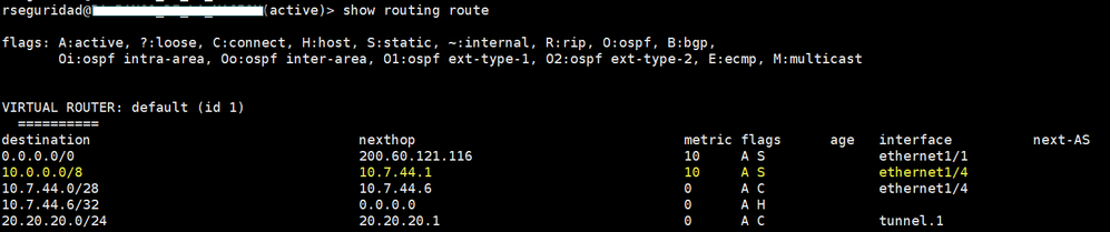

Hi there,
The FIB is used to determine the egress interface to reach a particular destination, typically the next-hop. The routing table contains all unfiltered/ permitted prefixes and their preferred next-hops.
show routing route
...is the CLI command your want.
It is worth noting that the RIBs associated with dynamic routing protocols may contain additional prefixes which due to routing which have not been added to the routing table.

When I query the "show routing route", the command shows me the following.
I understand from the output of the command, that to reach that destination, I do it through the ethernet interface 1/4, but I do not understand why when I do a "ping" with origin, it does not work (And according to what I understand, it should work).

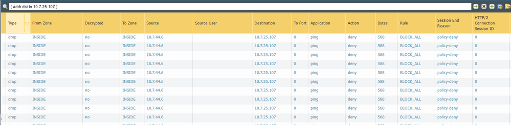

Is it necessary to have a security rule to allow traffic from the Ethernet1/4 Interface for ping tests to my destination 10.7.25.107?????
I have checked the rules, and also the logs, and this is what I found.
It is necessary to create an explicit rule to allow me to simply ping from the eth1/4 interface to my destination ????.

Hi there,
The default intra-zone permit rule would have allowed this particular flow to work, but as you have shown, your 'BLOCK-ALL' rule is denying it.
Since you are pinging within the subnet from the eth1/4 interface this is covered by the intra-zone rule which cannot be reached, so yes, you need to explicitly permit it.

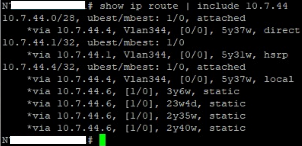

Hello, my friend.
I got this information regarding the SwitchCore machine that has the IP 10.7.44.1, which is the GW of my Palo Alto.
The Router with IP 10.7.44.1, knows my MGMT IP (eth1/4 of the FW), by a static route, as I show you in the following image.
All your explanation is clear, I just want to give "sense" to the explanation of why the "ping host 10.7.25.107" works, if according to the routing table, to reach that destination, I must leave through the eth1/4 interface and it does not work, but it seems that it does reach that destination through the MGMT interface of the Firewall (with IP 10.7.15.166).
Hopefully, you can clarify this theory.
