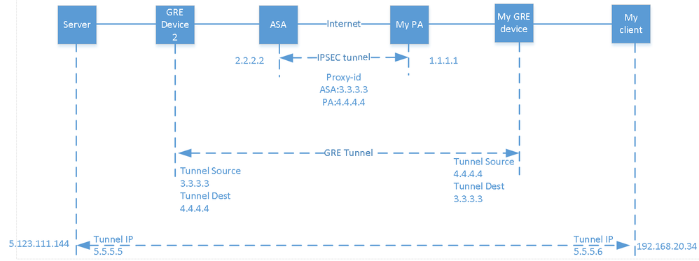

Referring to the following diagram, My client need to talk with the server 5.123.111.144.
stage 1, to get the GRE tunnel working.
My current is
1. the IPSec tunnel is up.
2. I am using a Cisco router as the GRE device, the tunnel config is
interface Tunnel2
 description GRE
 ip address 5.5.5.6 255.255.255.0
 tunnel source 192.168.55.250           >>>>>>>>>>>>>this IP will be natted to 4.4.4.4
 tunnel destination 3.3.3.3
3. the security policy for the GRE tunnel is
trust zone > ipsec zone, source IP 192.168.55.250, dst IP 3.3.3.3
ipsec zone > trust zone, source IP 3.3.3.3, dst IP 192.168.55.250
4. NAT policy
trust zone > ipsec zone, source IP 192.168.55.250 source NAT to 4.4.4.4, bi-direction is yes.
till now, when I ping the tunnel dst 3.3.3.3 with source IP 192.168.55.250, I can see the ping log on the PA and the log showing 192.168.55.250 is being translated to 4.4.4.4, but the ping is failed. I cannot see any packet from 3.3.3.3 in the log. what the issue could be?
stage 2, get my client be able to talk with the server 5.123.111.144.
whats the security and NAT policy should be?
Thank you.

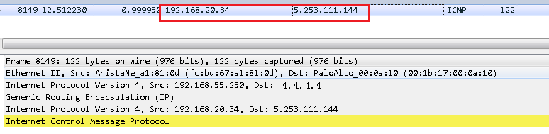

I took a pcap on the PA, the packet I got is, but cannot see it in the log

About the second part of your question - I really don't understand what you want to achieve... From the diagram I understand that you will bring GRE tunnel between two Cisco routers. This traffic will be routed through IPsec tunnel between ASA and PAN FW. What I don't understand is what are "tunnel IP 5.5.5.5" and "tunnel IP 5.5.5.6". Is this another tunnel inside the GRE? Or your want to "hide" the client ip behind 5.5.5.6 and the server behind 5.5.5.5?
hello @A_Astardzhiev
for stage 2, what I want to achieve is
1. the tunnel IP can ping each other, 5.5.5.6 <> 5.5.5.5
2. the client 192.168.20.34 is able to ping 5.123.111.144
for 1:
I need to add static routing on PA for dest 5.5.5.5, point to the ipsec tunnel interface and add static for my side tunnel IP 5.5.5.6, point to internal interface, as before adding the routing entry, the PA goes to 5.5.5.0/24 via the default route to the internet
So the outbound security policy should be
trust zone > ipsec zone source 5.5.5.6 to dest 5.5.5.5
inbound security policy should be
ipsec > trust zone source 5.5.5.5 to des 5.5.5.6
is this correct?
for your question about stage2
Or your want to "hide" the client ip behind 5.5.5.6 and the server behind 5.5.5.5? --- exactly.
I have static routing "ip route 5.123.111.144 255.255.255.0 tunnel 2" on my switch, so when my client 192.168.20.34 pinging 5.123.111.144, the GRE switch will add extra header S:5.5.5.6 D:5.5.5.5 before the raw packet header S:192.168.20.34 D 5.123.111.144
So I dont need to create policy for 192.168.20.24 <> 5.123.111.144 as the packet header has been changed after the packet leaving the tunnel towards to PA.
I hope I am making sense(excuse for my bad English)

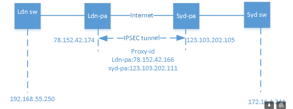

As I cannot connect to the ASA to initial any traffic for testing purposes, so I simulated the settings on our 2 PAs.
The diagram is
172.16.4.241 is natted to 123.103.202.111
192.168.55.250 is natted to 78.152.42.166
SYD-PA config is
1. static routing to 78.152.42.166 point to the tunnel interface
2. outbound security policy is from trust zone 172.16.4.241 to ipsec zone 78.152.42.166, allow any
3. Inbound security policy is from IPsec zone 78.152.42.166 to trust zone 123.103.202.111, allow any
4. NAT policy is from trust zone to ipsec zone, 172.16.4.241 source NAT to 123.103.202.111, bi-direction is yes
LDN-PA config is
1. static routing to 123.103.202.111 point to the tunnel interface
2. outbound security policy is from trust zone 192.168.55.250 to ipsec zone 123.103.202.111, allow any
3. Inbound security policy is from ipsec zone 123.103.202.111 to trust zone 78.152.42.166, allow any
4. NAT policy is from trust zone to ipsec zone. 192.168.55.250 source NAT to 78.152.42.166, bi-direction is yes
my testing result
on syd sw, ping 78.152.42.166 from 172.16.4.241, ping failed.
I can see the ping log on SYD-PA and the log detail shows the NAT was triggered.
I cannot see any logs from/to 123.103.202.111 on ldn-pa

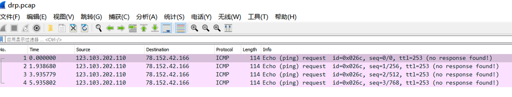

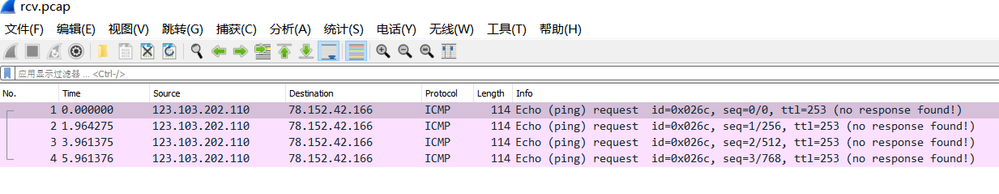

I started a pcap on ldn pa and I can see the icmp packets in drp.pcap and rcv.pcap
I've no idea where the issue is...
